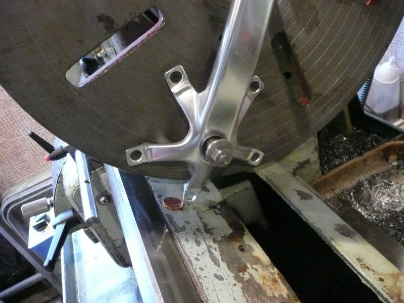

In my case the other day the answer was "only just". I had planned to shorten a pair of cycle cranks, overlooking the fact that the spider carrying the chainrings projects slightly more if the outer spider arm is in line with the crank (some have the inline arm inboard). In the event, I was just able to get the job in by removing the sheet cover to the bed. My photo shows a 1p coin declining to enter the gap.
