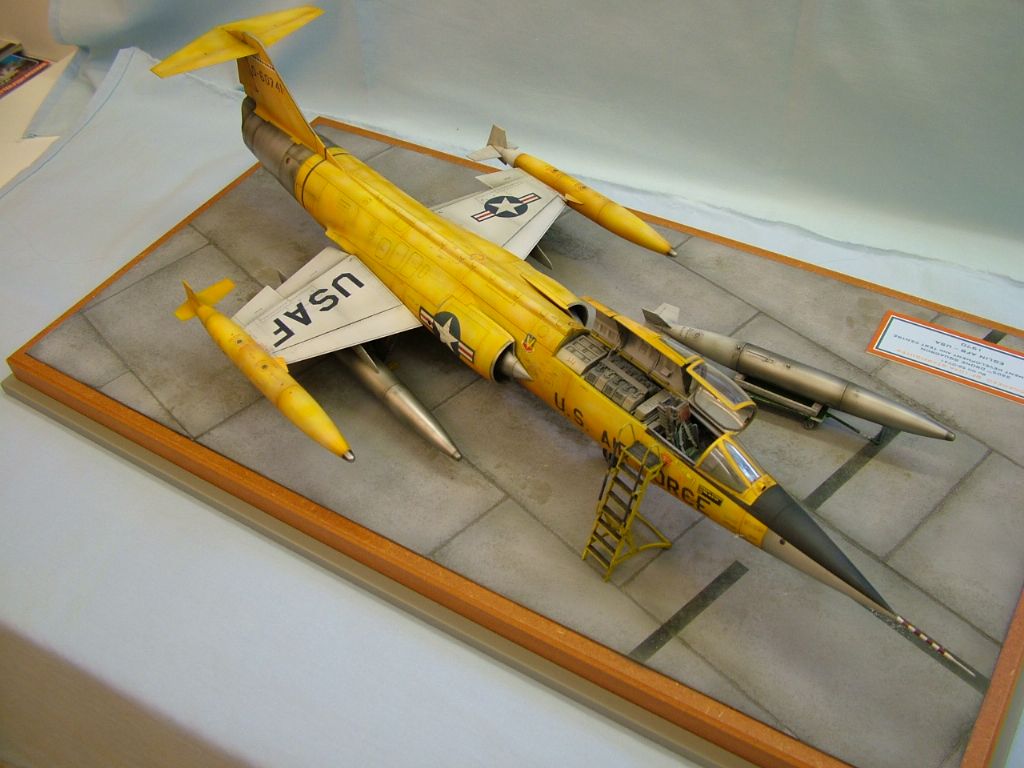

Reading through your initial post again Doc at a metre long and 200 wide solid wood would be risky indeed especially with a waterline model.
Just a thought but does it have to be a wood finish? MDF as suggested could be painted in a complimentary or contrasting (to the ship) colour. Any thought as to a cover going over it? A secondary under base can provide support for that.
Something like this perhaps?
All my models have picture mount board card covers over them that sit on the lower edge to protect from dust but could just as easily be acrylic or glass.
Just another thought perhaps
