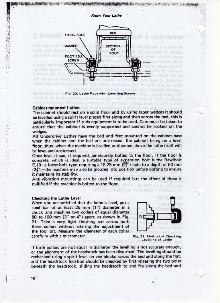

None of my machines are bolted down.
Instead they are mounted on antivibration machine mounts.
Boxford in their instructions for installation give effectively three ways to go.
The Centec 2A is on one of their monster cabinets and is very stable despite or because of its weight.
My Startrite pillar drill I admit is a little unstable and probably should at least have some outriggers added to the base to extend it. I haven't fixed it down as I haven't actually fixed its position in the workshop. Not danced with it, though!
As AW2, it's easier to rearrange ones workshop if needed if they are free standing but mine are lightish machines. You wouldn't want to do it with yer Colchesters and Bridgies...
