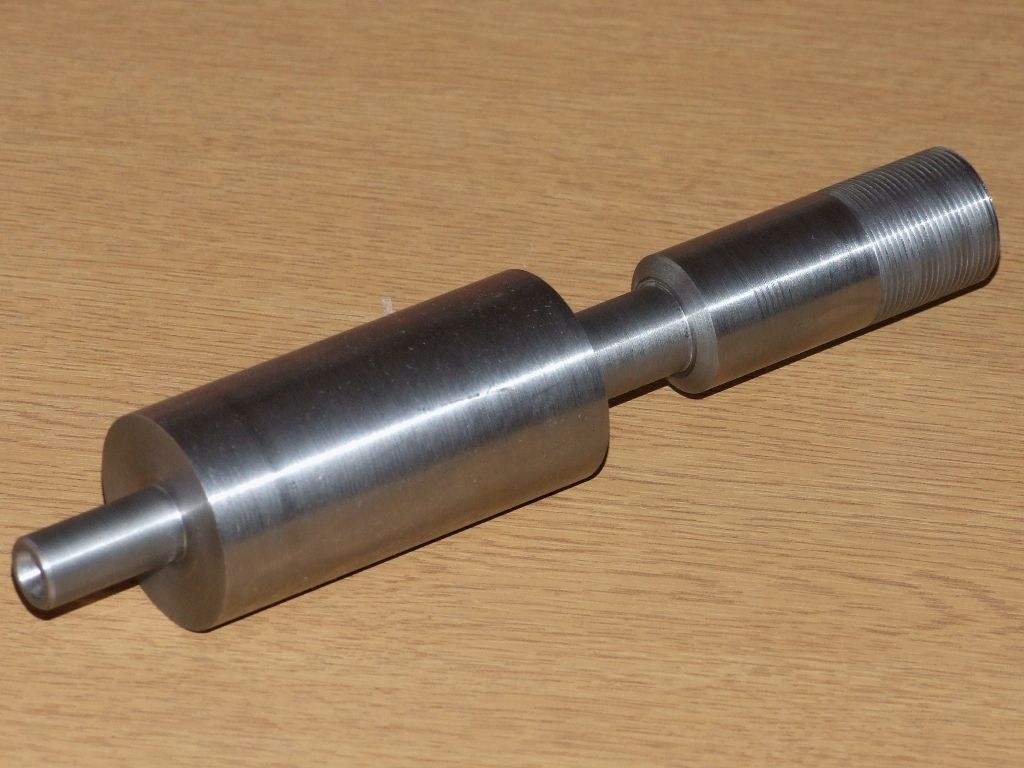

I've just broken another one; that's the second one in as many weeks. Fortunately the broken bits came out easily. It was the last turning operation on my embryo hob for a worm wheel:
I'd have been right put out if the part had been scrapped. If nothing else it's 30 quids worth of silver steel.
The centre drills I've been using are a no-name set I bought many years ago, from an ME supplier, although I'm not sure which one. I've just put the whole lot in the bin; best place for them. I'll keep the nice wooden box they came in though. On Monday I'll order a new set from a reputable professional tool supplier.
I never use centre drills for starting twist drills on anything other than the lathe. When drilling on the mill I either start straight with a four facet twist drill, or use a carbide spot drill.
Did I say I hate centre drills? angry 2
