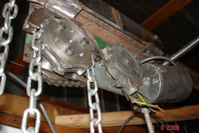

dsc00231 (640x427).jpgMy hoist could be adapted to work on a short boom. My set up has a rail made by welding two lengths of angle iron back to back. My hoist is mainly used to lift the 8" 3 and 4 jaw chucks for my lathe, I don't think I would try lifting the 6'" 4 jaw now. The hoist is powered by an old garage door opener motor (36v), but run on the 18v power supply that I use for the power traverse on the vertical milling machine.
Ian S C

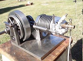

dsc01315.jpgHi Clive, I intend to stay on the forum a while yet, and maybe get some useful work one yet. Got an open crank 4 stroke motor to finish, just got to design and build the ignition. The coil will be under the base. The pulley beside the flywheel is for a fan besided he cylinder
Ian S C
