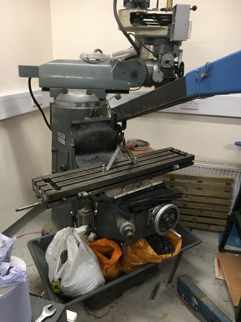

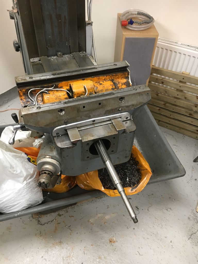

Went out into the workshop last night and stripped down the table on the Bridgeport clone. I have had new ballscrews for the X and Y axes waiting to be fitted for several years now. The CNC conversion was delayed by our move back to the UK, then by the purchase of a proper CNC machine. I have 90% of the conversion parts made now and the original leadscrews have pretty much had it now. A DRO makes up for a lot of the backlash but surely the ballscrews will be a vast improvement and will allow me to make some progress with the conversion to CNC. I have to retrieve the "yoke" that holds both the X and Y axis nuts so I can machine it out to take the very slightly larger diameter ballnuts.
Took almost exactly an hour to remove the DRO, power feed, handles, leadscrews, table and finally liberate the yoke. Biggest challenge was sliding the 42" table across to the left to disengage it from the dovetails, given the lack of space. I may move the machine out from the wall before refitting but for now it gives me more space to work.

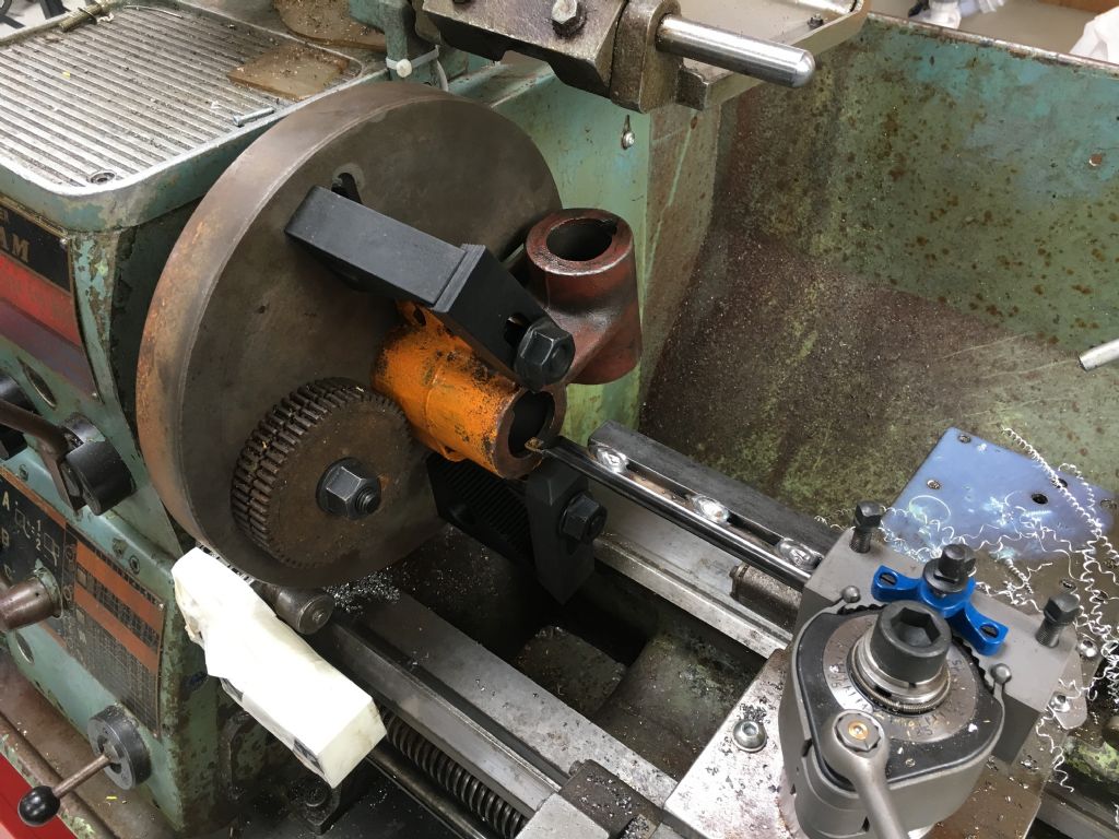

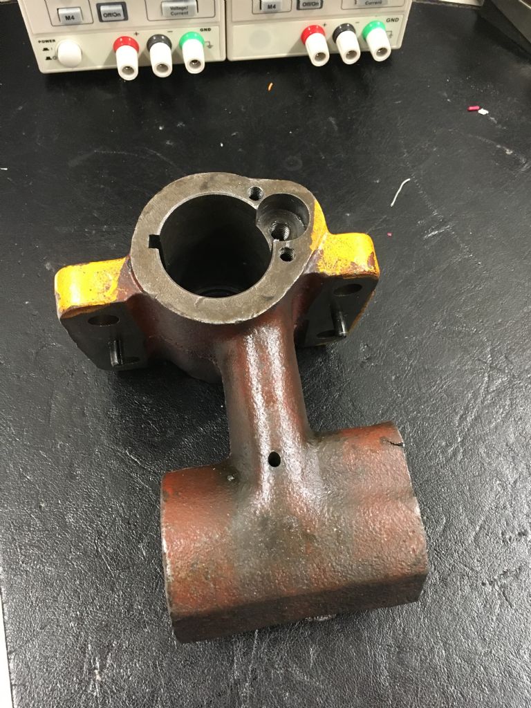

Here it is. I checked previously that it is small enough to swing on the bantam faceplate. I need to bore both them out to 40mm bore, so annoyingly, that's only 1/4mm - so near and yet so far. But I need to add fixings for the flange of the ballnut anyway.

Machined out the bores in the yoke (see earlier post). Had to make up a long boring bar by welding one of my SCLCR bars onto a piece of 3/4" square BMS. Worked very nicely and I took them out to 40.1mm which gave a nice sliding fit.

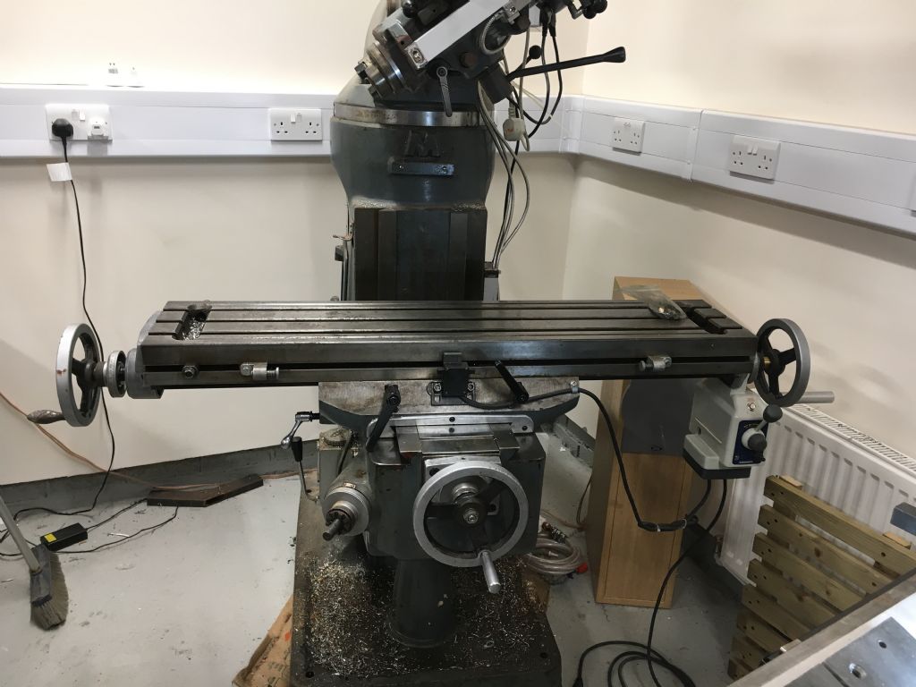

Refitted both ballscrews and reassembled the machine. No dramas or grievous cockups. I'll need to make up a spacer for the X axis handwheel, as I designed the ballscrew to accommodate a toothed pulley which isn't fitted yet. Although I haven't formally meassured it, the backlash on the Y axis has gone down from a large fraction of a mm to something of the order of 20um (~1 thou). That's a massive improvement.
Back together
I'll refit the DRO, way covers etc later. Been up since 7, so time to call it a night.

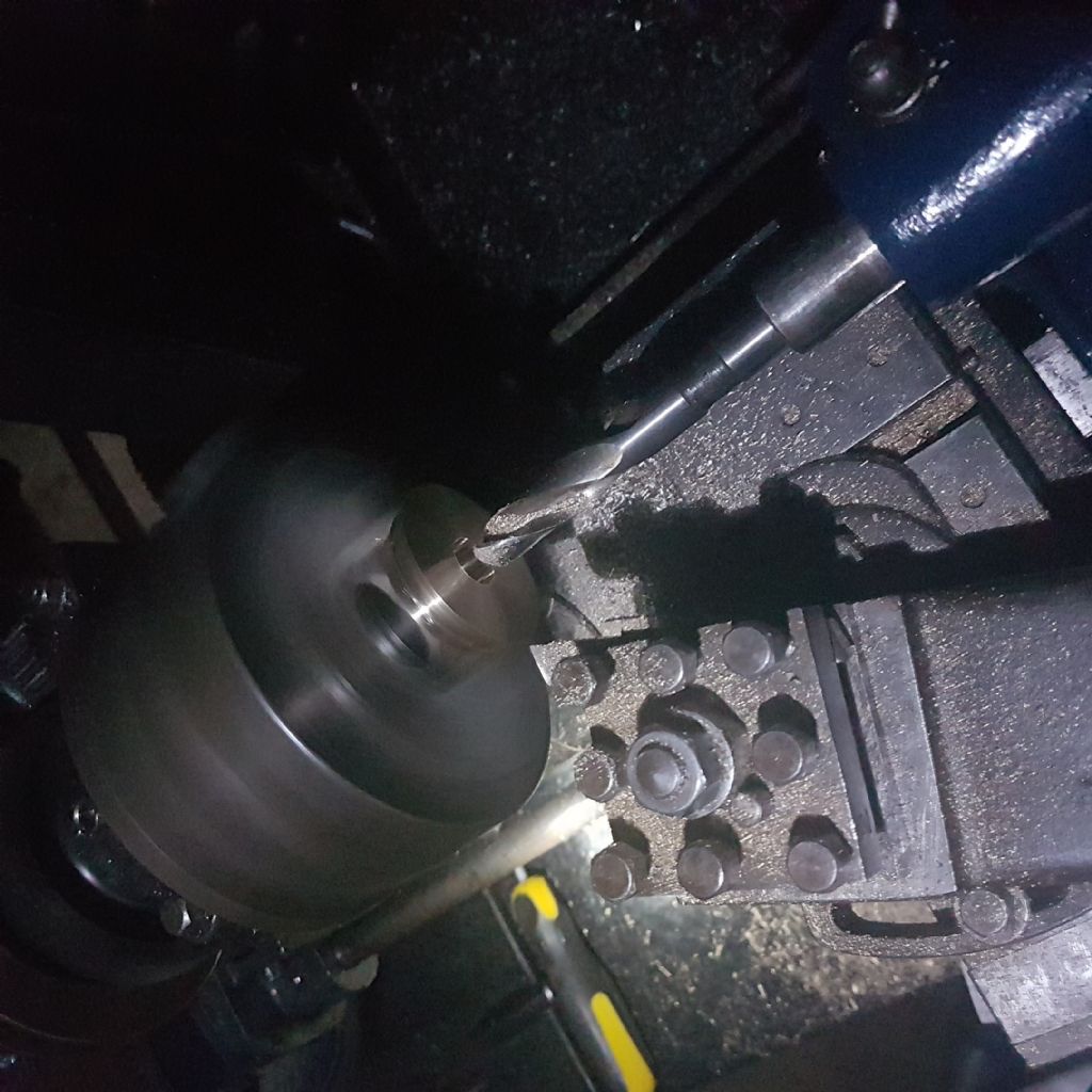

Faced off my faceplate, the faceplate didn't look as though it had ever been skimmed.
Before
During
And after. Less than 1 thou out over the 7" faceplate. Not bad for a knackered old machine
