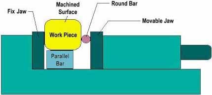

Hi Ed,
Just a different take on this for what it's worth. Harold Hall modified a cheap (£10) drilling vice by some basic machining and making a newer, beefier movable jaw. The mods he made to the vice enabled it to be used as a reasonable milling vice. He argued that with 4 fixing holes and a low profile he found it more than adequate for most milling that a model engineer would do. This is in his 'Complete Milling Course' book in the section where he discusses and actually questions the need for a milling vice - pp 86 on. For example, to square up some plate as you are trying, rather than using a vice, it would be better to clamp it to an angle plate fixed to the bed of the machine. You could also clamp it to the bed of the machine on raising paralells or similar and mill front and back at the same time, Turn the work 90º (check with an accurate square) clamp and mill the other edges. More than one way to skin a cat.cat. Harold speaks from quite a common sense no nonsense point of view.
Such a vice would not be suitable for heavy industrial work but for light work they can be more than adequate. I have one fixed to my milling machine and often use it in preference to my larger much more cumbersome dedicated milling vices for my modelling work and it is capable of some surprisingly accurate results. A toolmakers precision vice would be a nice aquisition, as would a Rolls Royce, but some of us have to be content with a Ford Fiesta.
Remember that even with a much more expensive vice, work which is required to be held vertically is usually clamped with a round bar between the moving jaw and the workpiece thus clamping it accurately against the true vertical of the fixed jaw to eliminate the possible effects of the jaw lifting out of parallel under clamping forces. Even expensive vices will have some lift, miniscule perhaps, but inevitable especially as it wears. An exapmle of the technique is here, it is a good way of compensating for just the problem you have encountered.
This is an image showing the technique which is described here (scroll down to bottom of page).
Don't get downhearted by the doomsayers sad there are ways to work around problems without throwing money at them and it's more satisfing when you succeed smile.  Of course if you are going into production or paid work it may be a completely different kettle of fish.

Hi Terry,
If you read my post again you will see the improved version of your round bar mentioned. The magnets really do help by holding the bar to the movable jaw, allowing you to operate the clamp whilst tapping the work down on the parallels with a rubber hammer.
For any beginner reader, when tapping the work down on to parallels you will find that any form of metal hammer tends to bounce the work of the parallel. From experiments carried out with all the different types of knockometer that i have, the best is a rubber one. I found it to be even better than a commercial "dead blow" hammer and much cheaper too, as it is made from a rubber door stop! Any form of metal, even a copper one, tends to send "shock" waves through the work piece which then lifts the work. I dare say a new copper hammer is soft enough but the head soon work hardens while the hide end, from my experience, is too soft.
Perhaps another tip for beginners using a milling vise, if you have one permanently bolted to your mill table don't put it in the middle. If you put it towards one end a. you will have room to mount other devices at the other end and b, if after everytime you have to remove it, to fit larger work, you put it back at the other end of the table you will even up the wear on the lead screw and gibs. Putting the vice bang in the middle causes all the wear will be in a small range only. Although there many ways of holding work on a mill you will find that a vise is by far the most convenient., once you learn to hold work squarely that is.

Hi Chris,
I did read your post thoroughly but I thought that a picture and reference to some good advice on other websites might be useful for a beginner so I took some time to do that. Sorry if I appear to have trodden on your toes, it was unintentional, merely trying to be helpful.

Terry, my dear chap,
You did not tread on any toes and your picture explained better than words could ever do.
