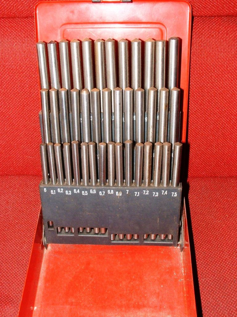

dormer drill blanks 6.0 to 10.0 x .10mm.jpgHello Robin
David has described the best way to use telescopic bore gauges, I have a set of Mitutoyo which were bought second hand many moons ago, I find they give better accuracy than earlier posts, but then I have been using them for many years. I usually measure over the gauge with a digital vernier.
Another advantage of the tel gauge is it will indicate if the bore is bell mouthed by the different dimensions over the gauge.
Several methods of measuring bores in my photo album, drill blanks above are simple to use as gauging the hole if you don't need the precise dimension.
