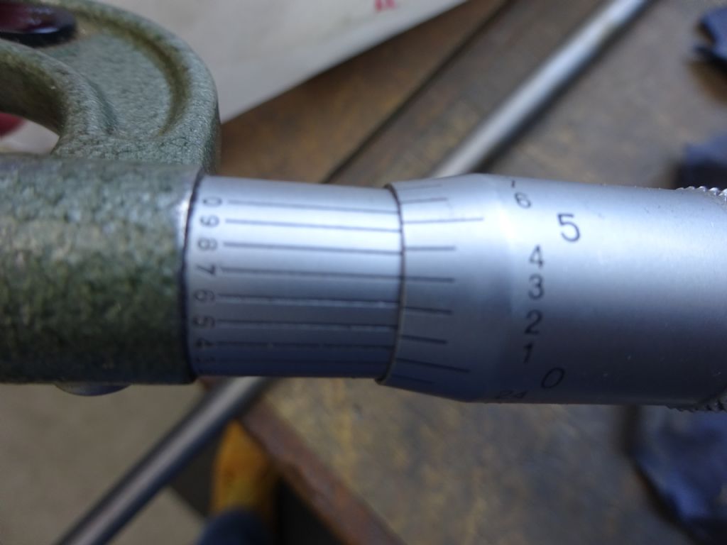

Just unwrapped and measured some 10mm PGMS, used the imperial mic as I prefer the feel of that over the digital (metric) one.
10mm = 0.3937" and on both ends I measured 0.3937"
And especially for Michael that last 0.0007"
Afraid I don't have anything that will measure to 100,000ths or 1 micron like the OP but as said if it did it would not measuer the same now as it did when I took the photos as the shed is starting to get some sun on it. A taper of 0.00008" over 12" is not a lot.
Edited By JasonB on 03/07/2018 08:46:02
Edited By JasonB on 03/07/2018 08:51:58

Mitutoyo 0.0001" one about 35yrs old. It was my brothers when he started work but he gave it to me when he went from BL to BMW.
Despite having said I don't have anything that will measure to 1 micron I do infact have one of their digital mics that displays to 0.00005" or 0.001mm but don't find that as accurate to use as the thimble has a friction rather than ratchet drive and it's a bit larger and unbalances so i find I can't get very consistant readings.
