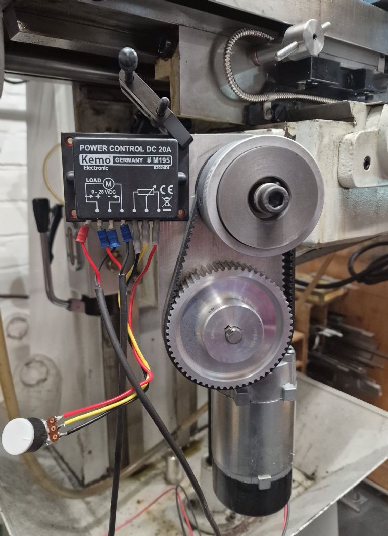

Posted by Stueeee on 22/01/2023 19:08:29:
When I modified a bead rolling machine from hand operation (where you need 3 hands) to powered. I used a 24V stairlift motor of similar power to yours. The motor runs through a similar PWM controller to yours and uses a 20A 24V power unit bought on ebay.
That's a good looking mod Stueeee, I am impressed. Have ordered a 24V, 25 amp power supply from Amazon so should find out in a few days if this does the trick.
22/01/2023 18:59:21
Thanks John, you clearly know much more than I do about motors and how they work (which is not difficult given my shallow level of knowledge) The DC motor only has two wires exiting the body and if you remove the cover on the bottom of the motor there are no terminals or any options to change the wiring configuration. I think the motor 'is what it is' as they say. I am changing direction with a simple switch that changes the polarity of the input voltage. Am I not right in assuming that this DC motor is 'symetrical' in operation when you switch the input polarity? Should I just get a power supply that has a peak output of 20 amps and see if that works?

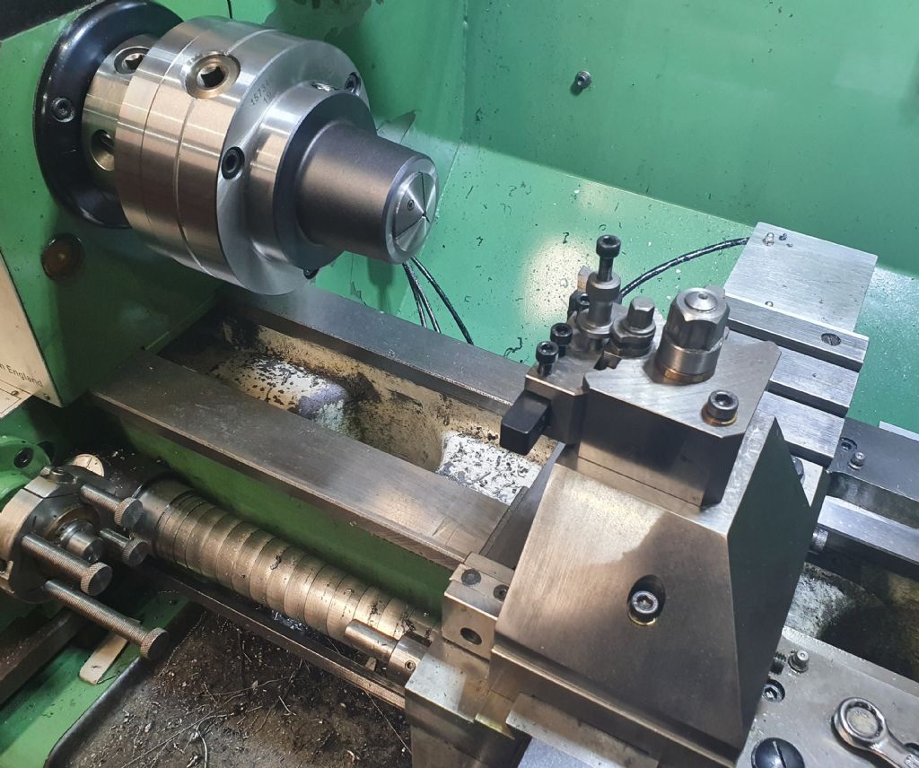

That looks great Optical.
I did a similar mod for my machine as below. Really very easy to make and it is definitely solid. The rigidity of the toolpost stiffens the whole topslide as well.
Edited By lfoggy on 22/01/2023 17:43:22

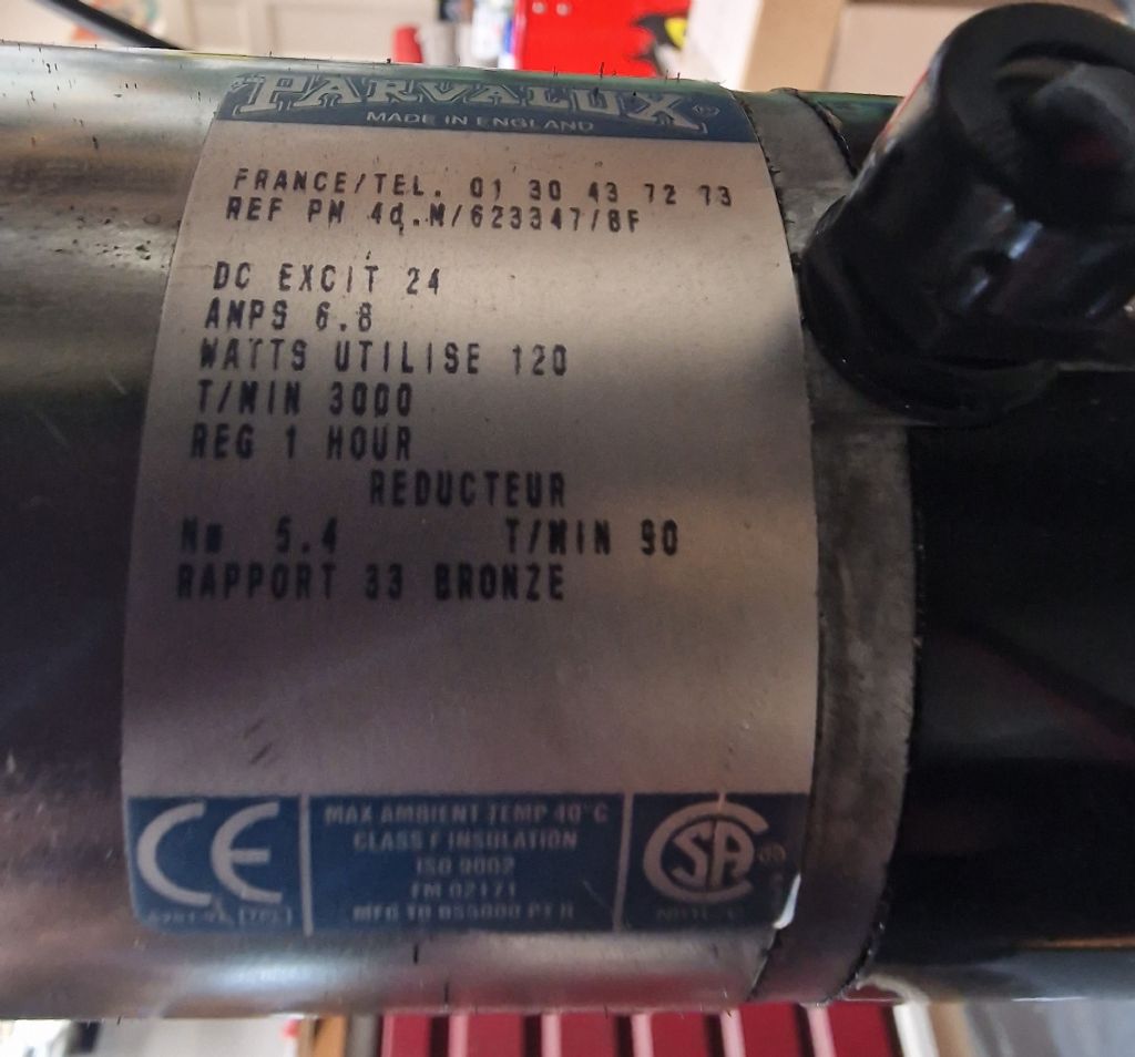

I'm building a power feed for the knee of my turret milling machine and need some advice on the power supply I require. I've got a Parvalux brushed 24v DC motor rated at 120watts. Motor is fitted with a worm reduction gearbox so output speed is around 90rpm. Should be more than enough as my 18v cordless drill driver will wizz the knee up and down no problem. I've done the mechanical bits and have been testing the system with a 5amp 24v DC power supply I have. It lowers the knee no problem but can't always get started elevating the knee. Once its going though it seems OK. I assume the motor draws more current when starting elevating the knee as this does require considerably more torque.
The motor data plate says 120 watts and 6.8amps which is odd as 120 watts at 24 volts is 5 amps? Is that the peak current in starting? Also I am controlling the motor with PWM type power regulator rated 9-28v and 20 amps so that should be OK. With no load on the motor it all works perfectly.
Pics of motor plate and setup below. Question is what DC power supply do I need here to make this work ? Please assume no knowledge of power supplies or their characteristics.....
Any other advice? Thanks in advance.
