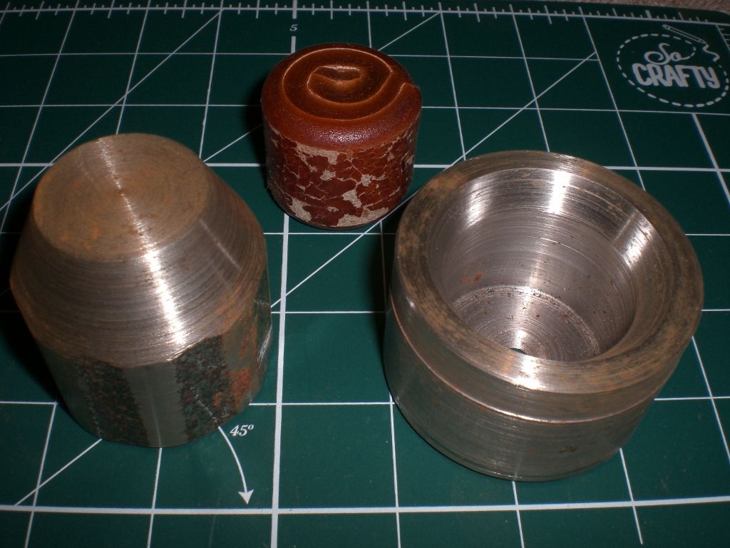

Hi Simon, I actually made the tools that not done it yet has referred too, from drawings and instructions from the Thor website, **LINK** . They didn't take all that much making, but you do need a couple of lumps of good steel, one about 50mm dia. and one about 60mm dia. and both 40 to 50mm long for a No. 2 size hammer. I didn't go to the trouble of hardening and tempering them as per instructions, as I don't think it is needed for the few times they may be used.
When I used the tool to swage the opening out, the opening just fractured and some of it broke off completely before it opened big enough to get the new hind in. This doesn't mean that this will happen on every hammer though. I have been thinking of a way to fit a new piece to the hammer to solve my problem, but haven't found any spare time to do that so far.
The copper ones are not worth the effort to replace, but they can be used until they are thrashed to the death.

Hey Thanks Nicholas, I've downloaded the info from Thor as per your link, now I KNOW it's a lost cause.
But the other thing that comes out of this is that the instructions from Thor say make the "combination tool" from BDMS then harden to 58 - 60 Rockwell C. B****dy funny mild steel!
I have another cunning plan, which I'll have a play with over the next few days. If it's worthy of notice I'll upload the results.
