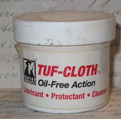

Rod Neep05/05/2016 21:18:20
avatar
59 forum posts
This stuff is brilliant.
I have been using this one small 2" diameter tub on carbon steel knives, etc. for years. The tub contains an impregnated cloth. One wipe over and the steel/iron is rust proofed.
Rod
