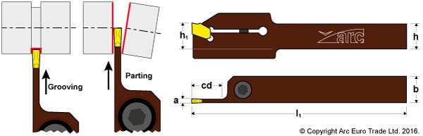

After a spot of parting off unpleasantness:
I had to buy a new tool. The one I went for came from Arc Euro Trade - pretty much a direct replacement for the Glanze:

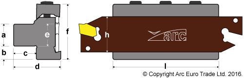

This works very well, but I wondered about the other design of holder Arc offer:
I don't understand why the first type is advertised as a parting tool only, but the second as a parting and grooving tool. Can anyone enlighten me about the functional differences of these two designs of bit holder?
Robin

Marketing. Parting is simply a groove taken all the way to the centre. Any parting tool can be used to cut a groove. But any grooving tool can only part off to the depth the tool can be plunged into the job.

On the top one, the tip is just a tight slide fit in the angled slot, and the stiffness of the tool is determined by the depth of the blade. Protrusion is selectable by to the user.
The lower one clamps the tip with the capscrew, but has a stiffness mainly determined by the shank depth in the toolpost slot. The shoulders force a minimum protrusion.
My choice would usually be the top type for stiffness and versatility - I can't readily think of a reason I might choose the lower one. Perhaps if you need all positions of a 4-way to be available it might offer less occlusion at the rear?

ARC MGEH one piece clamp type Parting & Grooving Tool Holders
Suitable for external grooving, parting, turning, relieving, profiling.
Each tool holder includes:
  • MGMN200 TiN coated insert
  • Hex Key
ARC MGEH Parting and Grooving Tool Holders - DiagramsHi Robin
Can you see the left arrow above the grooving arrow?
This tool can take small cuts side to side.
Cheers Michael.

What Michael says, inserts held in place by a screw can take light side-to side cuts as well as fore-aft ones.

In the OP the top tool is for parting only, with inserts for same. They do not like taking small cuts. In my experience anything less than 4 thou per rev and they chatter.They can be used to turn grooves, but it's not a nice experience, only done it once. If I need to cut an accurate groove I use a HSS toolbit as they don't chatter with fine cuts. However, if you get the conditions right the insert parting tools work well:

The lower tool in the OP can take a multitude of inserts and has a different, more positive, clamping arrangement, rounded inserts are particularly suited to profiling, like this:

Michael, Neil and Andrew,that holder that Michael shows is not what the OP shows. The tip are different and have better side cutting geometry and can therefor cut sideways which is why the MGEH is also described as suitable for profiling, even more so with the round nose inserts.
The QA-GTN that the OP posted just uses a standard GTN parting insert but due to the holder being stiffer (sideways) will be better able to cut sideways but at the expense of not parting as deep as the blade type will allow.

I've got both the first Arc parting tool the OP shows and the MGEH. The MGEH I have actually has squarer ended inserts. It's more prone to the insert slipping backwards when parting hard. I've also tried the other style and my impression is that all the ones with screw clamps are better for sideways cuts although the MGEH may well have the advantage for this.
In practice I tend to make multiple straight in cuts and then take a fairly light side to side cut to finish, although the other day I shaped a domed end on a steel bar with the MGEH by eye which was all side cutting, just too lazy to change tools
Parting under power with TCT inserts is an eye opener, the only issue I have come across is that when cutting alloys you get build up unless you use cutting fluid. Uncoated parting inserts seem to be like hen's teeth.
