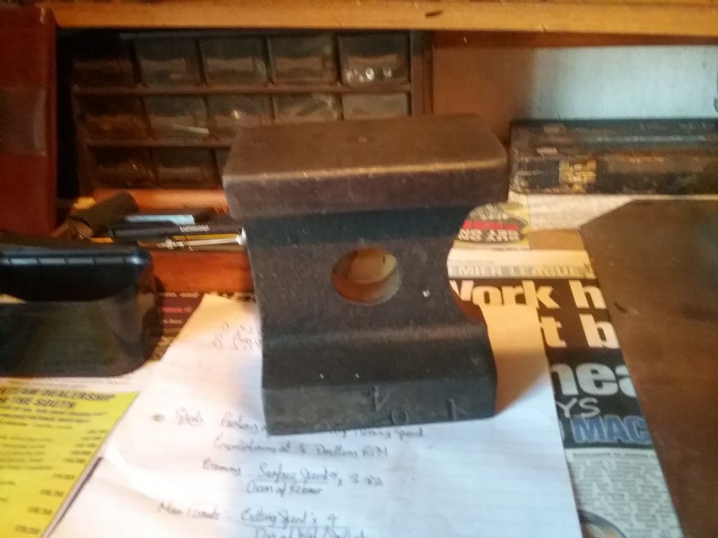

Nicholas Farr26/06/2018 22:31:18
avatar
3988 forum posts
1799 photos
Hi, I made this one about 30 or so years ago, was lucky enough to get an off cut of a brand new length while cutting six lengths to size for a new weighbridge for the company I used to work for then.
Mick, your plan sounds reasonable to me, but I would cut the base back a bit like on a normal blacksmiths anvil to allow your shaped bit to over hang the end of the bench. The base can get in the way at times when using the shaped bit.
Regards Nick
