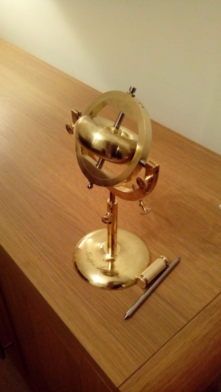

MW14/12/2017 13:33:18
avatar
2052 forum posts
56 photos
My display picture is actually of me, turning a new gimbal ring for somebody, I also made a few other bits anew. Such as the screws and the clasps. Heres a pic of what the final result was.
Was a very interesting exercise, if not a little hair raising boring the 8mm brass ring.
Michael W
