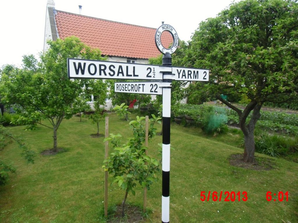

No1 Invicta we borrowed the castings from an aveling that was getting repaired,one of the 1st castings I did many years ago,No2 me pouring[never mind the junk behind!! hehe No3 2/1 scale traditional fingerpost signs we used to have round here alas all gone now, this miniature is ,in my front garden between Worsall & Yarm Rosecroft is our cottage, no 4 is the 2 part pattern with core print for the North Yorkshire c c top of the post, all letters cut out on the Hegner,No5 is one of the roses with 2 different pouring sprues,one with a pouring baisin,, one without, not much difference to be honest, No6 straight out of the flasks with a brass firebar off a 2" traction engine [for a friends ornament ] wouldn't last 5 mins in his firebox!!,lastly the 2 roses mounted on the pediments.
  Oops !! go to part 3 for pictures of  what this is all about!!
Edited By the artfull-codger on 29/03/2022 19:51:16

dscf0481.jpgdscf0472.jpgfinished fingerpost sign making 008.jpgdscf0480.jpgdscf0479.jpgdscf0474.jpgHi Luker, sorry about the delay re "yorkshire rose" these are traditional yorkshire roses not with lots of separate petals [& they have to be displayed the right way up!!] & a few other snapshots of castings I've done.in the past.dscf0476.jpg
