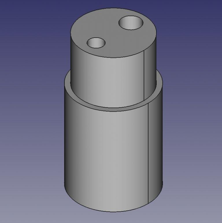

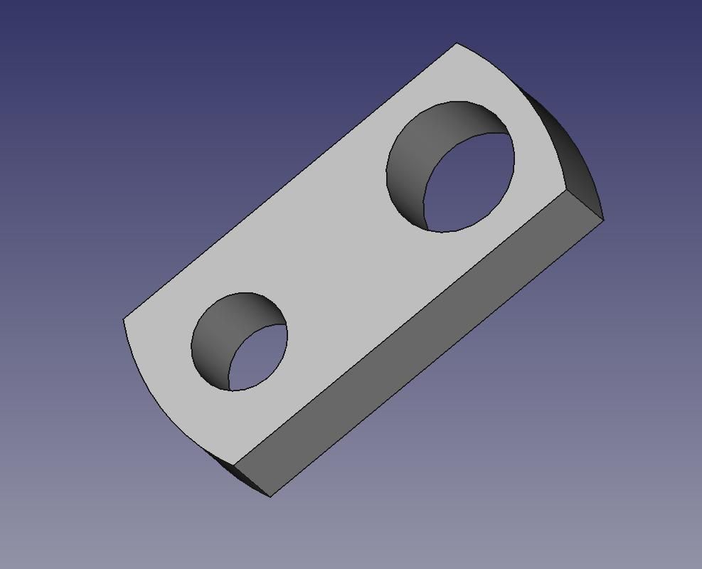

I'm making a matching pair of side arms for a crankshaft. The finished arms look like this and are mild steel about 12x28x6mm in size:
I'm thinking of making them by turning and drilling a rod thus:

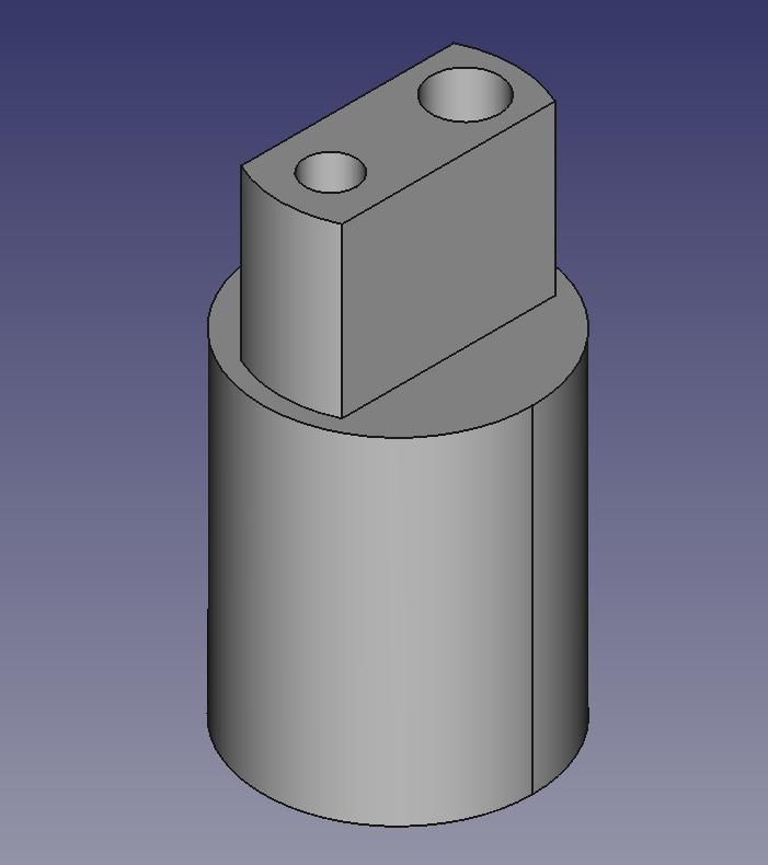

Then milling the sides:
And finally producing the finished crank arms by parting them off in a lathe. I'd use a carbide blade in a rear tool-post.
The sequence has the advantage that I can grip the work firmly during all the machine operations, both lathe and milling.
But the last stage has me worried because the parting cuts in a lathe will be interrupted because of those milled flats. Am I foolish to attempt making the arms by parting them off? If it is a daft idea, how else might a pair of identical arms be made?

I would be more inclined to slit or saw of otherwise looks good to me.

I think it would be fine dave, only risk might be to an insert tool where the tip might get knocked out, so a solid tool would be safer. I think I've attempted far worse than that otherwise. :P
Keep the speed of the lathe fairly steady, a bit faster than might use for a round bar, maybe 700 to 800rpm as a guess, to avoid stalling the spindle on the knocks.
I'll presume you realize that by parting, you'll inevitably leave a pip of some sort when it falls off. Maybe you're a lot better at it than I am. So the back would need to be skimmed again to finish or maybe just filed off if you're not so fussy.

What if you significantly 'straddle' the continuous round bar with your parting tool to reduce/ practically eliminate the interruption to the cut?

Considering you will have to set it up in the mill to machine the flats the slitting saw idea would be easiest .

You could turn down the OD and then put two parting cuts in to stop just inside where the two holes come, over to mill and do the holes and flats then back to the lathe to complete the parting off.
Or soft solder two discs onto the end of a bar, do all you machining and then melt them apart so no parting needed.
Or saw off the first one, face the bar and saw off the secont and then mill or turn to finished thickness
I usually make them from flat bar and use the mill to set out the holes accurately so the two parts match

If you are worried, part off with by parting the major (continuous) diameter section of the bar, with the edge of the tool just at the intersection of the continuous section and the milled section. Any clean up or bringing to final finished width can be done using a 4 jaw chuck.

The only times I've broken an inserted tool in my rear-tool post has been during an interrupted cut (done it twice now) - admittedly on larger work (< 2" ) - managed to break a large chunk out of them both. First time I thought it was just bad luck, got away with it on the next cut and then banjaxed a second insert on the third.
So last time I used a HSS blade (from the front) to get past the 'interrupted' section (gentle stepped cuts - in, back, feed over a bit, in, back, feed back again) and once I was past the 'knock' - I had made a wide enough channel to feed in the inserted tool straight from the rear...
A compromise solution - but I don't like taking deep cuts with the HSS tool from the front and my (inserted tip) rear tool holder doesn't seem to like being 'clunked'... although it works really well on deep parting cuts normally
Others here seem luckier with their inserted tooling but different lathes/users/tools behave differently. Anyway, that's what I do now.
Your job is a bit different in that the 'clunky' bit extends just about the whole way. So once you've moved over to the mill, I think I'd stay on it and just cut them off as other have suggested.

I really like the slitting saw suggestion. Apart from being to position the cut accurately and getting a good finish, the work can be left in the mill. There's no need move it back to the lathe. The only disadvantage is that I may need to buy a larger saw.
