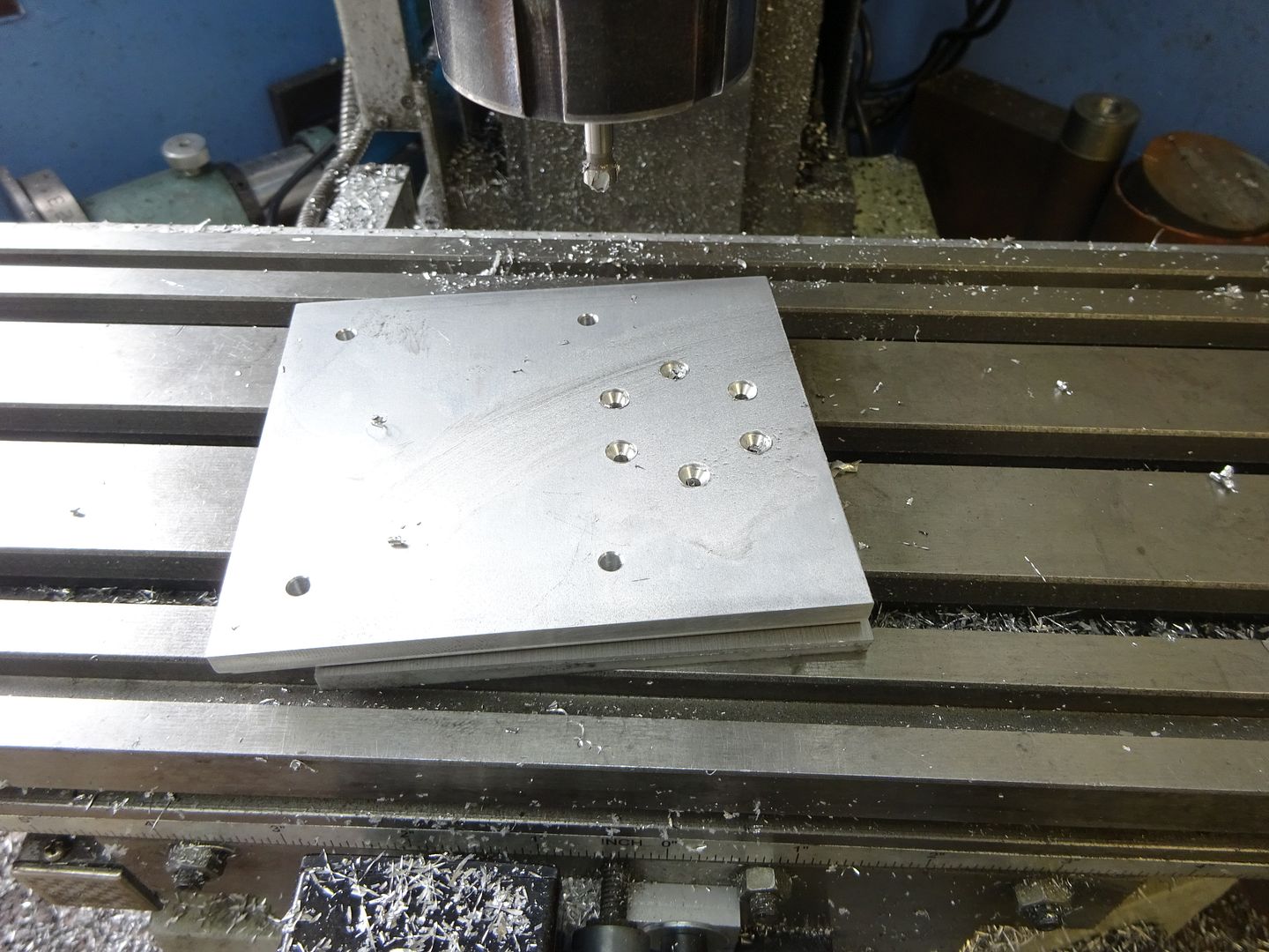

Vic the idea is to actually spot them deeply to form the CSK as the first op and then drill the hole but can also be used afterwards.
Another good make of the 3 flute ones that Andrew showed is Ruko, this is one of their 6mm head ones on a 5mm shank into 6082

Agreed, I've also got a Ruko one of the same size as the Guhring one. Whichever one I find first in the drill drawer is the one that gets used. Both work well.
