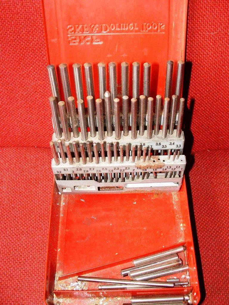

A few months ago I had the opportunity to buy sets of HSS Drill blanks, 1-6mm and 6-10mm by 0.10mm increments for a very low price. Since having them have found they are very useful not only for hole diameters but also for measuring slots cut on the milling machine.

Plus one for the drill blanks. After that it is small bore gauges and telescopic gauges plus luck but usually close enough for things I make.
