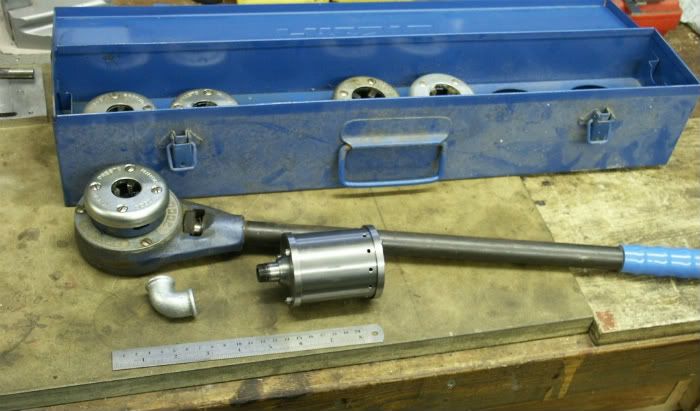

JasonB04/02/2016 19:01:39
avatar
25215 forum posts
3105 photos
1 articles
I get this out when the hit & miss engine models need a large pipe thread.
Holding the part is usually more of a problem as our plumbing friends don't think twice about using a pipe vice with its heavily grooved jaws which would chew up our sort of work.
