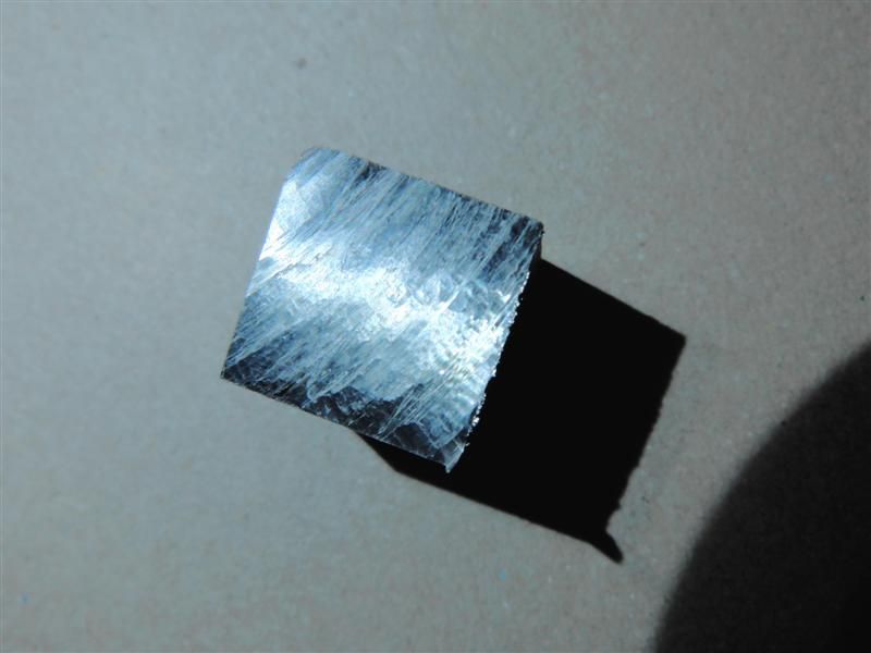

Posted by Roger Head on 28/11/2015 00:16:13:
Posted by Versaboss on 27/11/2015 22:03:02:
Today you can get circular saws for angle grinders and hand held saws which cut every material, including steel.
I use two (large and small) of these Kaindl products, they do what they say:
http://kaindl.de/en/home-featured/kaindl-aktions-multisage-set-topcut-o120-o160.html
Regards, HansR.
I'd be interested to hear comments on these (or similar generics). Things like 'how thin' and (ignoring the obvious mechanics of size etc) 'how thick' the sheet material can be? What about round/flat bar? What does the cut edge look like (esp. on thin sheet), how much cleanup needs to be left, etc etc.
Roger
Seems that I owe you something Roger, so here it is. Just as a test I did two cuts with the angle-grinder blade, one in a scrap bracket from 1.5 mm steel, the other a piece of 15 mm square steel. Both cuts done in say 5-10 seconds, I did not measure the time.The parts stay completely cool, and the (very small) chips are natural colour also.
Then again came the difficulty to photograph these parts, in my pictures steel never looks like steel. May be the LED lighting has something to do with that?
Regards, HansR.
