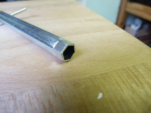

Posted by pgk pgk on 01/11/2015 13:10:52:
I'm intrigued as to why? If the current box is too long then trimming it and redrilling for a crossbar is easiest..or a longer crossbar.
If able to adapt the box you have then making a round bar to fit and milling/filing flats on it for your 10mm spanner should be easy enough and you don't need to insert into the tube and cross pin until it's right..
I included the photo to help illustrate what I need, which is; a length of hexagonal tube. An 8mm box spanner with the external wall formed into an hexagonal throughout its length will be ideal. So far, I have only found box spanners similar to the photo and no source of 8mm internal flats, hexagonal steel tubing.
01/11/2015 12:29:05
Does anyone know where I can buy a length of 8cm (at least) of steel hexagonal tubing with an external across flats width of 10mm and an inside across flats width of 8mm. In other words, to fit over an 8mm nut and be turned by a 10mm spanner. The photo below shows the business end of a box spanner with the type of hexagonal tube I am after. If push came to shove I could possible adapt what I have already got, however, if I made a mistake it is far easier to cut another piece from a much longer length of suitably dimensioned tubing rather than reworking another box spanner.

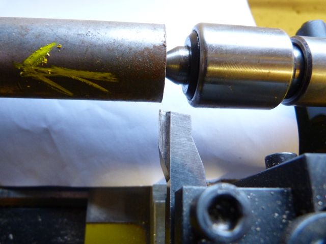

Posted by JasonB on 16/05/2015 20:31:33:
Looks OK to me, Just make sure the cutting edge is set to centre height and you are good to go
Thanks, and also to Jim C.
One hour of daylight left and I am now hot footing it back to the shed. It is reassuring that basic questions are treated in a sympathetic manner. Thanks again.
16/05/2015 20:21:31

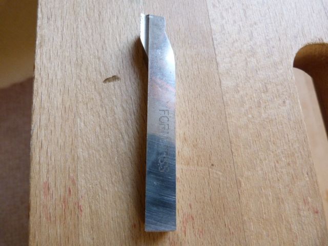

I am still finding my way around my lathe and wary of making a mistake after breaking a parting tool due to my ignorance. In the photo I have set up what I believe to be a Type 1 HSS left hand tool to turn down a bar, the direction of cut is from the right to left in the direction of the arrow, towards the lathe chuck. The tool itself is in the other photo. Will someone please take the time to let me know if this tool is set up pointing the correct way for the intended cut.
Many thanks
