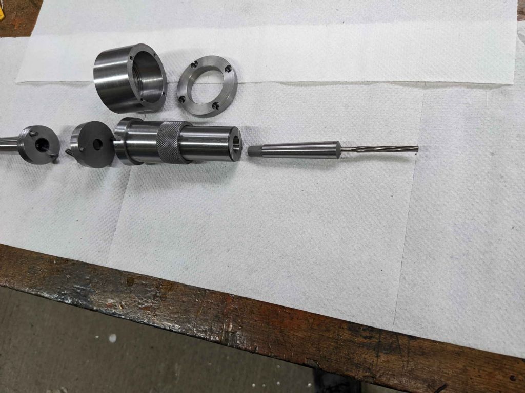

Hardly something I've done today, but an ongoing project, recently completed.
A Hemingway floating reamer holder!
And if you're interested, the parts explode as below...
