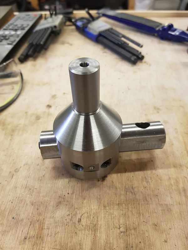

Decided that I needed a more robust fly cutter so dug out a bit of round bar and got to work. Ended up with a decent looking fly cutter which fits into a 19mm collet. The cross bar is 25mm diameter and drilled to accept a 12mm Hss bar. Now I need to learn to grind the Hss bit correctly and get some test cuts done.

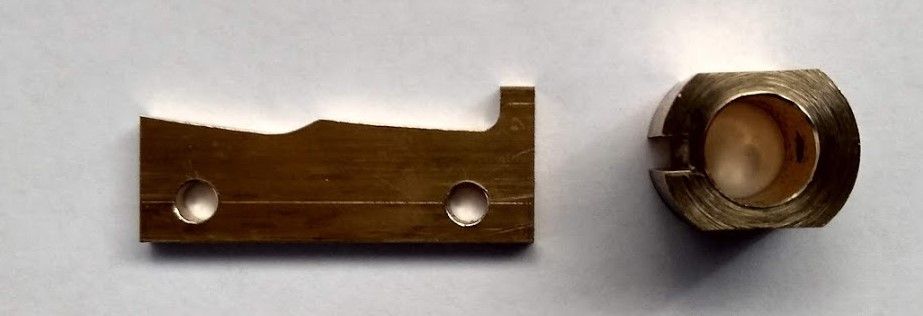

Yesterday finally got round to machining new pallet for my recreation of a Synchronome clock (see previous post on making the bob here.
Upper photo is the brass pallet and slotted collet. The pallet profile was cnc milled with code generated to form the "ideal" profile described in Frank Hope-Jones' book on Electric Clocks. All the calculations and g-code done in an Excel spreadsheet. Many hours of working out, about 5 minutes machining. The two M4 holes were to clamp the brass blank on to a composite backing clamped to the mill table, the big hole in the collet is 10 mm, the pallet made from 1/8" brass. Still need to do a bit of trimming and deburring, solder the pallet into the collet, and clean it up.
