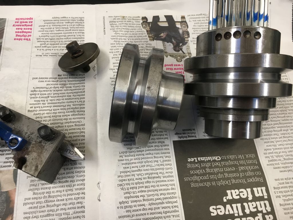

Sorry, that was a senior moment. I was planning to remachine it at 40 degrees, not 60! I've ordered a SPZ772 belt from beltingonline.com which should arrive before I've remachined the motor and spindle pulleys.
Managed to remove the motor pulley. The spindle assembly bearings pulled off easily enough but the gear and pulley seem to be pressed together. I've had to mount the assembly in the 4 jaw and although the gear end won't fit inside the body of the chuck, the stick out is fairly limited. The question is whether it's hardened or not ie can I use a simple HSS form tool or do I need to use carbide.
I looked closely at the shiny tops of the gear teeth, thinking this indicated where there was no wear. In fact, the shiny bits are ground, to take the bearing (which I have removed. The matt finish bits are a slightly smaller diameter. The gear is pressed into the pulley body, also contacting the shiny bits. There is a key and keyway in there too, to take the load.

Posted by Muzzer on 09/01/2018 12:15:33:
I looked closely at the shiny tops of the gear teeth, thinking this indicated where there was no wear. In fact, the shiny bits are ground. Murray
Not sure if you were also asking an open question to readers?.
To me, if it has been 'Ground' very close to the pulley 'V', then I would expect it to be hardened.
To confirm it, I would use a medium cut file to test the deflection from the surface in the 'V'. If the file stroke just slides over the surface and only polishes it, then it's also a hardened areal, so a TC Bit req'd, or grinding.
Lastly, if the stub shaft has been 'Centred' at the splined end, It would benefit from support with a Live Centre.

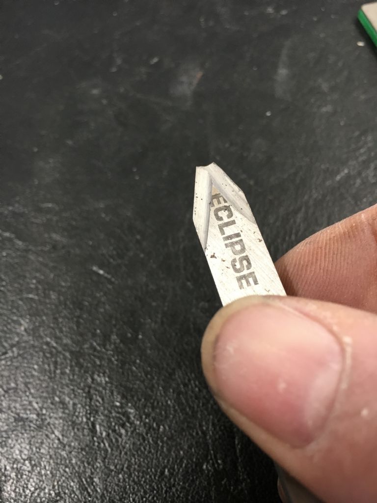

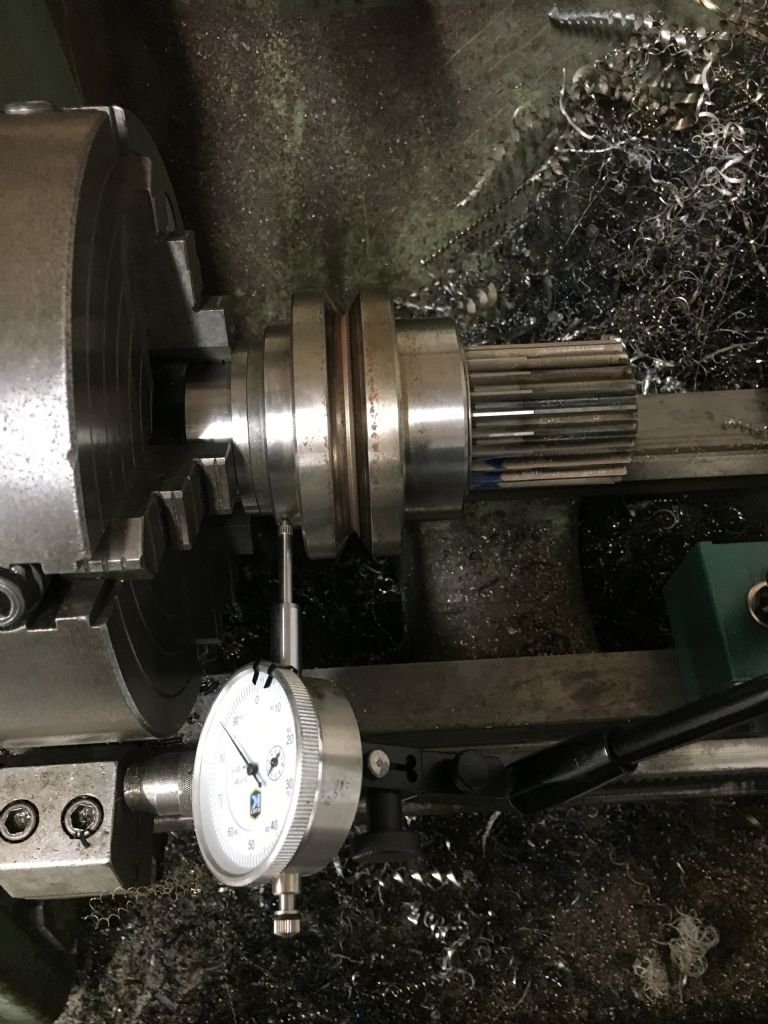

Muzzer09/01/2018 16:38:07
avatar
2904 forum posts
448 photos
No problem - as you guessed, the splined core is hardened but luckily the actual (outer) pulley is not. So I was able to make up a 40 degree form tool from a 1/2" HSS blank and set to. I ground the tool to give a large top rake by grinding a groove in the top surface and then honed it with a diamond tool.
The result was pretty good - lots of very fine "bum fluff" swarf during finishing but also some half decent swarf during the roughing part.
