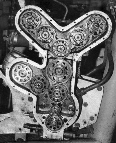

John Stevenson09/10/2014 09:38:49
avatar
5068 forum posts
3 photos
Innards of a Jones engine.
Not bad for coming out of a 12' x 10 shed.

Bill Pudney09/10/2014 09:59:21
622 forum posts
24 photos
Posted by John Stevenson on 09/10/2014 09:38:49:
What with all those straight cut gears and ball races, I'll bet that there was quite a racket when it was started!!
