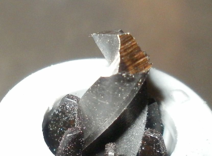

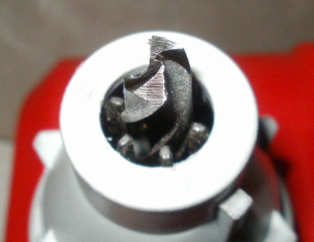

I got one of the Holzmann drill bit sharpeners mentioned today and have been playing with it this afternoon. Seems a solidly built unit and the "plastic" bits are thick and hard rather than flimsy. There is a video on the German parent website here .
I am not sure about the angles it produces though, the first grind, I'll call it cutting looks too shallow to me and the clearance angle grind which is done second barely touches the back of the cutting edge.
First picture shows after the main grind of the cutting edge...
And after the clearance angle has been ground
Not sure whether to return it or not.

Chris Shelton13/05/2015 16:48:37
avatar
92 forum posts
46 photos
Hi Andy,
I also bought one in the end, very pleased with it, but before you grind the clearance angle, you need to reset the drill position in the holder again.
HTH

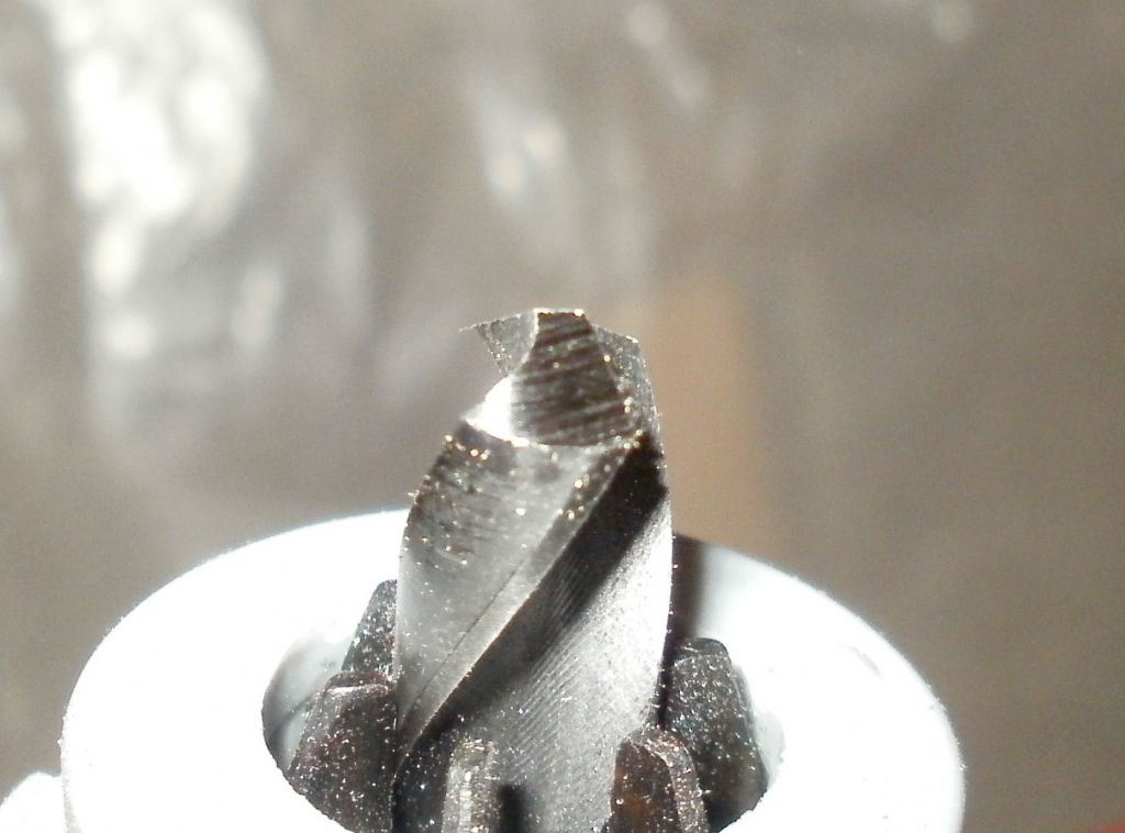

AndyP13/05/2015 17:13:30
189 forum posts
30 photos
Hi Chris,
That certainly takes more off but neither the instructions or the video mention resetting the bit between grinds, the video clearly shows doing one then the other all in one camera shot. It doesn't look right to me :-
Chris Shelton13/05/2015 18:00:49
avatar
92 forum posts
46 photos
Hi Andy
Not sure how to put youtube links on the forum, but if you look at the tradetools tv review of a re-badged version of the drill sharpener, he states you should reset the drill after sharpening.
Chris
AndyP13/05/2015 22:20:08
189 forum posts
30 photos
Thanks Chris, so it does, link here , now that is annoying, 2 sets of contradicting instructions for what appears to be the same device. I feel more inclined to believe the manufacturer though.
Andy

Dave Halford14/05/2015 12:49:38
2536 forum posts
24 photos
I would have said from the second pic the drill has been thinned too much. The cutting edge looks to have gone in the center.
I've got a Holzmann myself and I've noticed it's quite sensitive to hand feed variation which can give an off center grind effect if you don't take care.
It shouldn't need resetting for the second grind unless the second grinding station is set too high.
All I have done is regrind on the same setting if it looks off and that seems to fix it.
