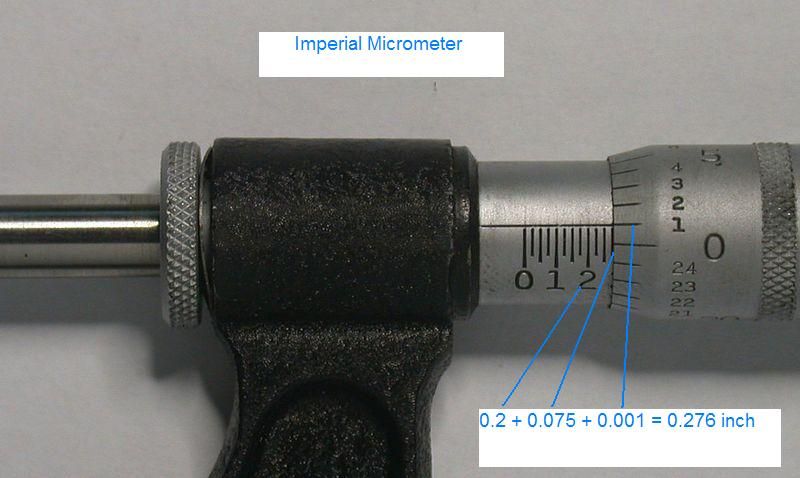

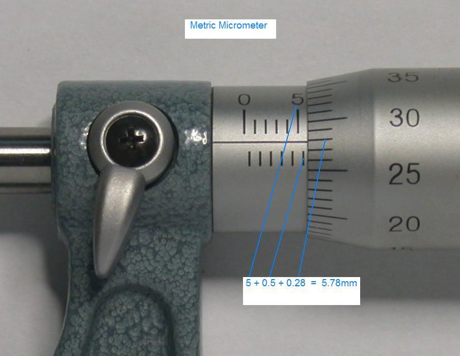

So whos gonna tell me how to use it?

Terryd27/01/2012 05:33:34
avatar
1946 forum posts
179 photos
Posted by Wolfie on 26/01/2012 22:06:50:
OK so you have convinced me its worth getting out the drawer and de rusting it. Its probably been at the back end of the cow barn since 1875.
Well OK its not rusted to death but its a bit stiff.
Edited By Wolfie on 26/01/2012 22:07:25
Hi Wolfie,
Perhaps this may help. How to read imperial and metric micrometers. Click on pictures to enlarge.
Imperial
0.2 + 0.075 + 0.001 = 0.276"
Metric
5 + 0.5 + 0.28 = 5.78 mm
Best regards
Terry
