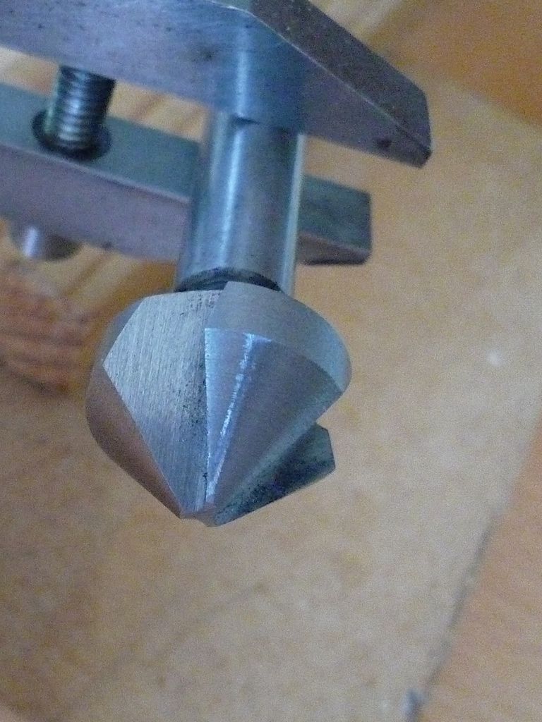

Thought you'd be interested in this one that led to the thread: photo attached. If you look at the 'land' i have photographed, you'll see it's buffed hard well back from the cutting edge. I've only used this one once.
Worth me sending back do you think?

This looks like a definite candidate for replacement if they will.
As you have photographed it there appears to be sufficient backing off but obviously there is some kind of land that is rubbing and 'picking up'. If they wont change it perhaps a stone rubbed across that point to reduce the area might improve matters.

I agree the single hole tools work well for deburring but for countersinking I always use a 3 flute TITEX brand (German) TIN coated. The finish on the TITEX tool however is almost mirror like, unlike the roughly ground example in the RJKflyer photo above. Speed is usually on the back gear on the mill so that is  under 100 rpm and keep the pressure on, right on to where the depth stop is set.
