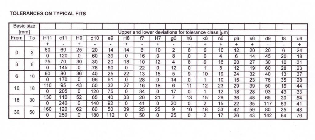

I want to make a bushing with a 7mm hole specifically to H7 tolerance. I had a look for a suitable reamer and came across offerings from sourcingmap on Amazon which have the merits of being cheap and being on next day delivery. However I can't understand the table of technical info:
I can't reconcile this with info from other sources which all tell me that 7mm H7 should be between 7.000 and 7.015mm. For example, the entry for 6.5 - 13mm above suggests that for a 7mm mm reamer D will be between 7.000 and 7.005 mm and the H7 column gives a tolerance of +0/-0.027mm. Which seems to suggest the reamer might actually cut under size. Am I misunderstanding the table?
Perhaps I should steer clear and buy elsewhere ( think I probably will actually, ARC's offerings are only a few quid more and they deliver pretty quickly) but I'd like to know what the table above means. If anyone can elucidate I'd be grateful.

Methinks they've ptobably got the sign wrong on H7 and H8. Other than that, the values seem close to the standard. Having said that, I've got no idea what a D4 tolerance is.

The H7 column doesn't look right to me either - looks like over a thou interference would be within limits on a 7mm shaft!

JA17/05/2022 16:58:58
avatar
1605 forum posts
83 photos
I think the above table is a load of rubbish. It is interesting that copper is included. At work we broke over 60 1/2" reamers trying to ream holes in a copper block. We gave up and the research project was abandoned.
This is the table I use:
and the associated fits are:
A large D does not appear in either table. Given that reamers are usually H7 you can decide on the shaft diameter.

Looking again at Robin's chart I think the "D" in the right hand column is a typo.
