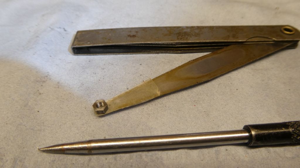

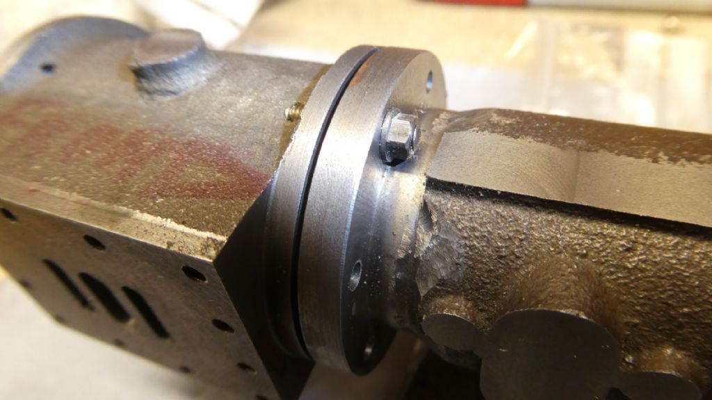

Having tried for far to long to get this 6BA nut started on its stud I gave up and asked my wife with her smaller fingers to have a go. She persevered for fifteen minutes or so but finally admitted defeat.
I tried a number of different methods including jamming the nut up a small piece of plastic pipe and using it as a flexible box spanner but the wall of the pipe was to thick and fouled on the raised rectangular sticky out thing on the casting.
The last thing I tried was to stick a piece of double sided tape to the end of a 40 thou feeler blade and stick the nut on the end. Now I was able to offer up the nut to the start of the stud thread. With the point of a scriber I gave the nut a twiddle or two and bingo, it went on.
I like it when things finally go right!

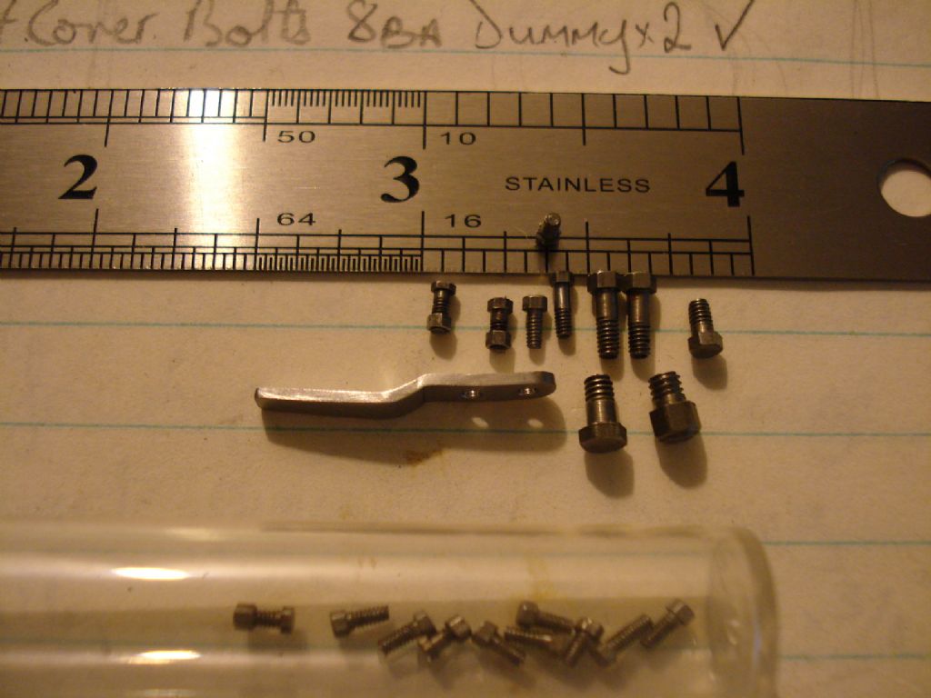

Makes me feel better to see others overcoming these tiny challenges as well. I have been twiddling tiny screws, nuts and bolts for a while now. I have a number of ways to start them on threads etc, primarily my favourite tweezers and cocktail sticks. Finish up with watchmaker's screwdrivers and specially made spanners. How small is small?-
How small is small?
Regards

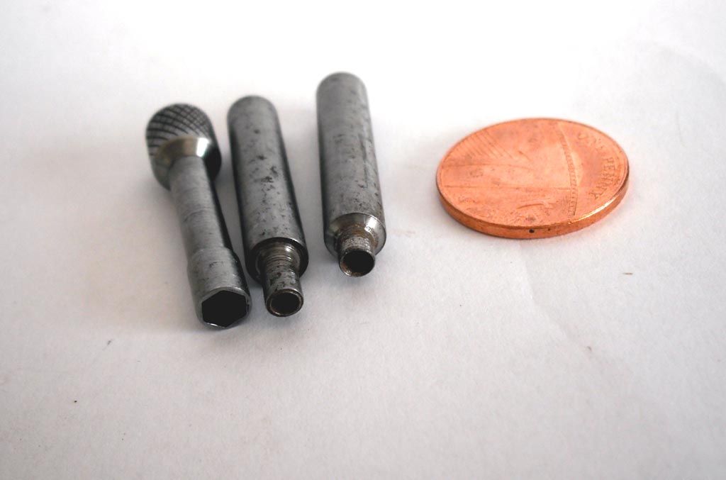

I solved the problem by making some miniature nut runners for 8, 10 and 12 BA sizes. Drill a hole the same size as the AF nut or bolt size and then knock in the end of a suitably sized hex key as a crude broach.
Edited By Anthony Knights on 29/03/2021 12:37:45
