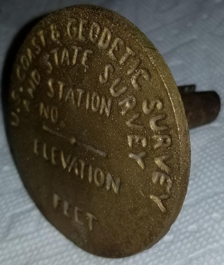

13/09/2020 23:43:59
survey monument.jpgIn my experience survey markers are called monumentation. I searched for Ordinance Survey Monumentation and found several pictures similar to the one I have included from the U.S.
