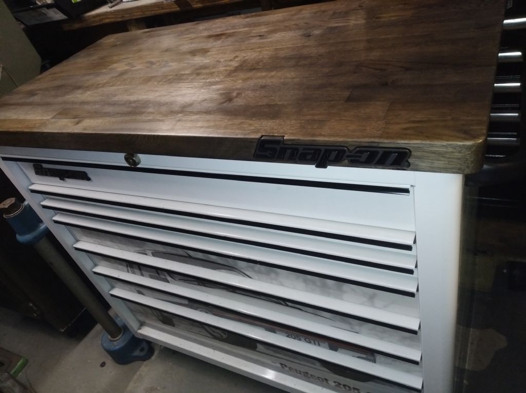

I have a work bench I used polyurethane on, it looks terrible when it gets scratches, it shows them up badly, I think acrylic type finishes will also suffer from this, I recently made a worktop for my toolbox from an oak kitchen worktop, finished it rustins Wood stain then a couple coats of their Danish oil, apart from being much easier, it doesn't show scratches, and doesn't look like plastic, if you finished with finer sand paper and another coat of Danish oil, you could probably make it a bit more gloss, but as it's a worktop I didn't bother.
Snap on worktop

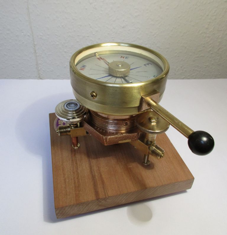

Hi IRT, I used a piece of walnut from the draw front of a very old chest of draws that were originally my grandmothers. The grain of the wood looks very pleasing to me and I tried some satin varnish and some regular yacht varnish on a couple of off cuts, but both made the grain look disappointing and kind of hid some of the texture. Having had a look online of various ideas, I tried some Danish Oil just on it's own and was very please with the result. OK, it only supports a compass made in the main of brass and bronze, but I think the natural look of the oil enhanced it's appearance,
Regards Nick.

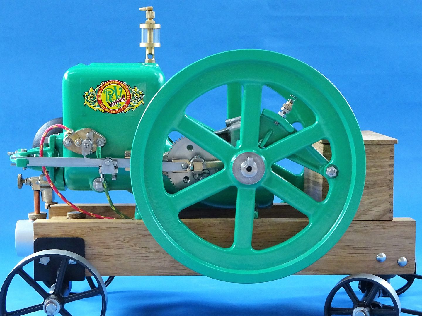

Linseed oil based finishes are very good and can be refreshed very easily but mixing your own can be a dark art. Firstly the Wood has to be sanded and the grain filled before the thinned oil can be rubbed in, just a few drops the using the palm of your hand to rub and generate a little warmth which adds the oil penetration. Multiple applications and each time allowing it to dry will give what's known in the gun trade a 'hand rubbed finish' which is very resistant to water and oil. If you want what's called a 'London finish' the oil has to have some dryers in it and will give a gloss finish with a lot of depth but takes many applications, search for Tru Oil if you want a high depth gloss finish. Using it you can get a finish such as this
