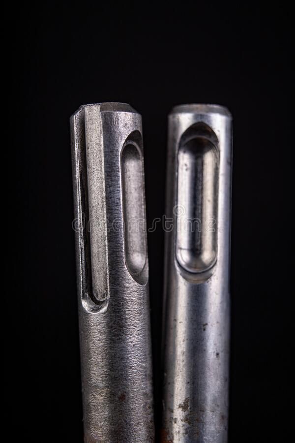

Well, I don't have an SDS drill but I do have some SDS drill 'bits'.
SDS Drills are obviously a "hammer" action drill but they also use a particular type of drill shank. It has slots in it, so I'd guess they are a feature of the SDS drill chucks too. I've used SDS bits in my Bosch (heavy duty) drill (in hammer mode) because I needed a longer drill and a certain size. I don't know where I got them from but they worked fine - although I'm sure it's not ideal in theory. I'll guess that the slots are to hold the bit more securely (presumably there's a matching feature in the chuck) given the vibration of the hammering rotation involved. It would stop the drill bit rotating in the chuck as can happen with a plain shank.

Over simplifying SDS is basically a specification for a fixed diameter shank with a sliding key drive.
The key turns the drill and the hammer unit inside bonks the blunt end of the drill. The drill is free to slide up and down the key for a short distance arranged to be greater than the hammer device stroke so the hammer force is transmitted to the work not the drill innards.

SDS drills have key ways in them so that they can slide in and out whilst being rotated. I think the name was penned by Bosch originally.
The reason why this arrangement is used is that the drill hammer action is different and much more effective than a normal ratchet type of hammer drill using a standard Chuck. The hammer action is almost universally pneumatic, meaning a lump of steel is thrown against the back of the drill (almost) by compressed air using a piston and cylinder. The frequency of strike is low, but the energy is huge.
Ratchet hammer action, by contrast, is accomplished by having the whole spindle, drill bit and chuck move backwards and forwards 40 (ish) times every revolution by a small amount. These are normally good enough, and cheap and simple. But performance and cost is much less than a pneumatic hammer drill.
