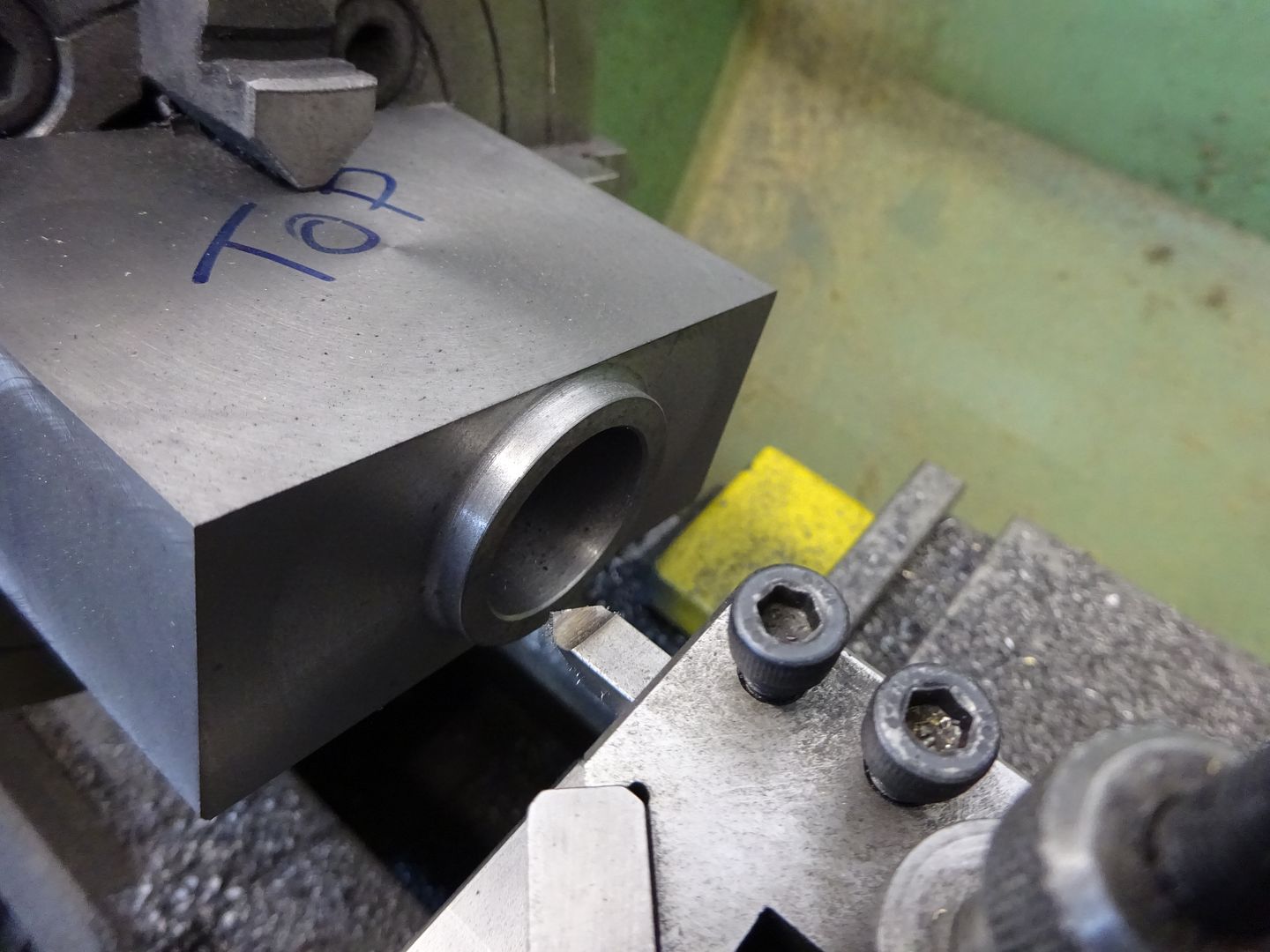

I use a 45 degree tct tool for relieving sharp edges on external shoulders
is there a tool for internal use?
i know a countersink in the tailstock works but a tool post mounted tool would be ideal.
again a boring bar set over to 45 degrees would work
but I’m after a tool i can just drop on to the QCTP and debur
does such a tool exist?

I use a flat topped 45° point on a full length 1/2" square HSS toolbit. The bit is sufficiently longer than the Dickson holder to accommodate a point on both ends.
Cutting edges hollow ground using the periphery of an 8" grinding wheel and kept honed really sharp between grinds.
For smaller jobs I use a Shaviv handheld pivoting deburring blade or use a countersink in the tailstock.
If its just a teensy burr I just use the Shaviv, even on bigger jobs.

I have a HSS tool ground 45deg on each side like a 90deg threading tool, held along the lathe axis it will do both internal and external corners.

I use a broken 6mm carbide end mill shank. I ground a 90-degree point on it then ground it flat across the diameter. Put a tiny radius on it and set it into a piece of cold rolled with a grub screw to hold it.
It does inside bevels, outside bevels and it'll take light facing cuts.
