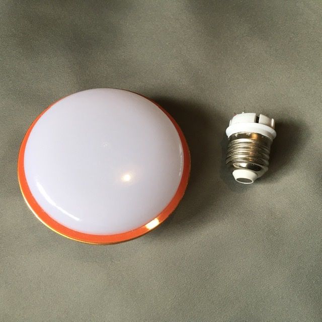

I don’t have sufficient data to assert that it’s typical, but a recent failure resulted in two visibly burnt LEDs in the array [one of which went open-circuit]. A replacement lamp also quickly failed ... and I am convinced both failures were caused by a poor quality light-switch.
Swapped the switch for a good MK one with a nice crisp action, and all has been well.

No ... The driver seems to survive, but I think the bad switch contacts are acting as a diode for a few mains-cyles: de-stabilising the driver and over-driving the LEDs.
To quote my previous post: ... a recent failure resulted in two visibly burnt LEDs in the array [one of which went open-circuit].
For the avoidance of doubt; that’s two LED chips in the array within a single ‘mains light bulb’

Just to keep the conversation going ... here are some pictures of my failed ‘flying saucer’
The two burned LEDs are clearly identifiable:
