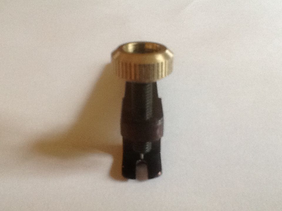

Can anyone guess what this little tool is used for?
It's actually a tool I made myself a few days ago, it's machined from a piece of 3/4x1/2 inch key steel. The threaded screw is a high tensile M5 capscrew with a knurled bronze thumb wheel added. The end of the screw is machined to form a tiny pin 2.5 mm long by 0.7 mm diameter.

Pure guess, it is to remove clock hands

I have a very similar tool but plier action, which is for punching holes through steel tape measures to fit joining strips where the tape has snapped. Never seen one of these before or since I picked it up - we now live in a throwaway age! (and yes I have used it, on a 30m tape and it works well. My son reckons I am a dinosaur)

I reckon it's for punching back the solidified plug of superglue in one o' them tiddy little bottles, only you need a longer pin. I tend to use a 0,75mm drill in a pin vice. Then I have to scrape out the glue from the flutes under magnification with the sharpened end of a rattail swiss file before I can use it again...

To push the pins out of Watch bracelets?

I have an identical one for removing the pointers from pressure gauges!

+1 & for pointers of watches

Adrian was there pretty quick, followed by a few others. I made this tool specifically for removing the needles on some Smiths speedo and tacho guages for my 1971 BSA 250ss Goldstar.
