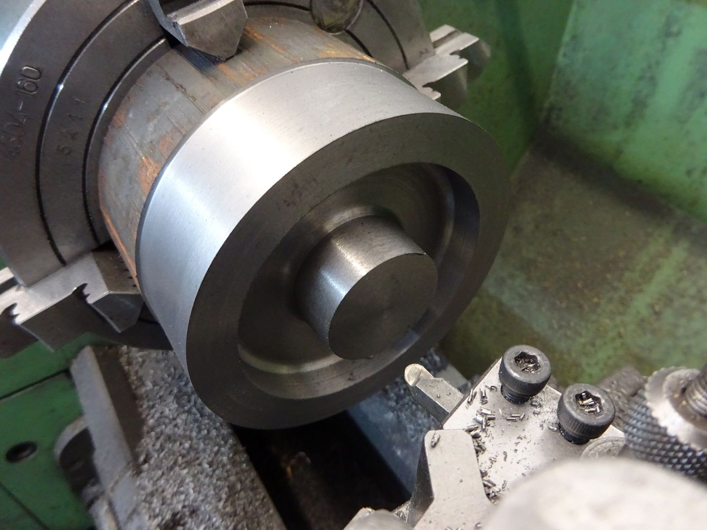

Iain Downs06/07/2019 11:11:17
976 forum posts
805 photos
As usual great advice.
The key was to take off the top rake. It's now 0 degrees - well, it might be one degree as per Andrew's suggestion, my hand grinding's not that precise. But it's no longer 10.
I reckon the rake was making the tool dig in and catch which was the heart of the problems.
Still requires a good deal of delicacy.

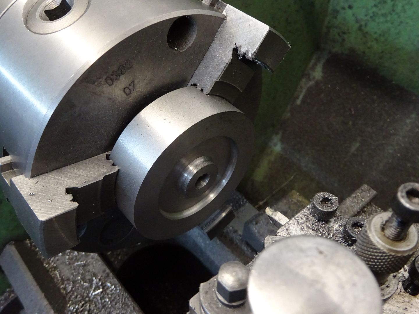

I could only get in about 1mm without it starting to jam, even though I'm convinced the relief was adaquate (and I kept tuning it), but in this case I didn't need a narrow slot so just plunged in next to it.
I also had a bit of a go at the point technique once the trough was done to start taking the bulk of the metal off.
As you can see it's starting to come together!
