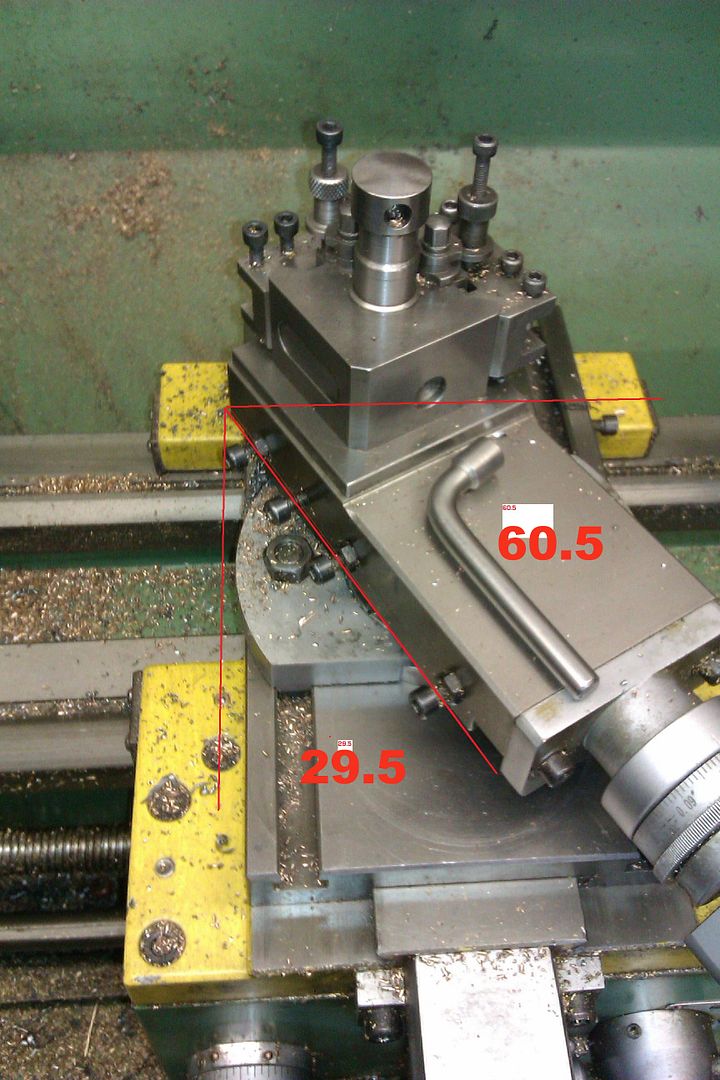

1. If it's an imperial lathe and you are cutting metric threads don't disengage the nuts.
2. Make sure you have the topslide at 30 deg (or 29.5) to the face of the lathe not the central axis

When cutting threads with the spindle in reverse the topslide needs to be angled opposite to what is used when cutting with the spindle going forward. The topslide should be parallel with the trailing flank of the tool, less 1/2* or so.

Indeed so, and it's probably also worth mentioning, that if Plasma wants to continue with that method, offsetting the top slide needs to be at 29.5° the other side of the cross slide handwheel.
i.e. the cut is put on the leading, rather than the trailing edge of the tool.
