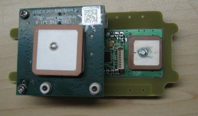

The SAT modem and GPS tracker - about 90mm long, 45mm wide and 20mm tall.

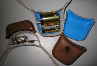

Here is a collar after more than two years, fitted to a Hyena, and removed after a monumental territorial fight between it and another male..
The strapping is extremely tough, does not tear easily at all, is 4mm thick, polyurethane and Aramid fibre, and the Hyena bite put 7 teeth THROUGH on one side and 5 on the other.. I suspect the collar saved the Bitten's life..
The electronics were still intact. but the combined antenna/battery supply cables were ripped out.
Upon recovery of the collar I was able to break open the encapsulation and remove the tracker, re-power it and extract the last available data logs from it - The tracker is wrapped in teflon tape prior to encapsulation specifically so that the resin does not touch the electronics, rendering it unrecoverable.
See how the M4 bolt below is also bent...
