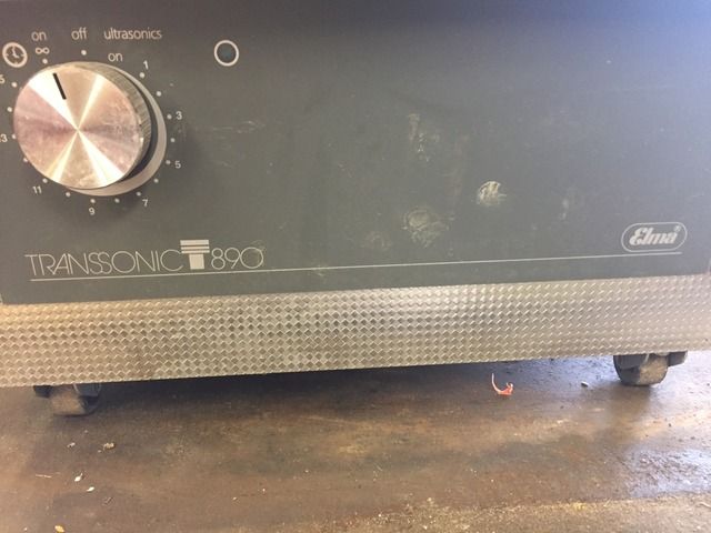

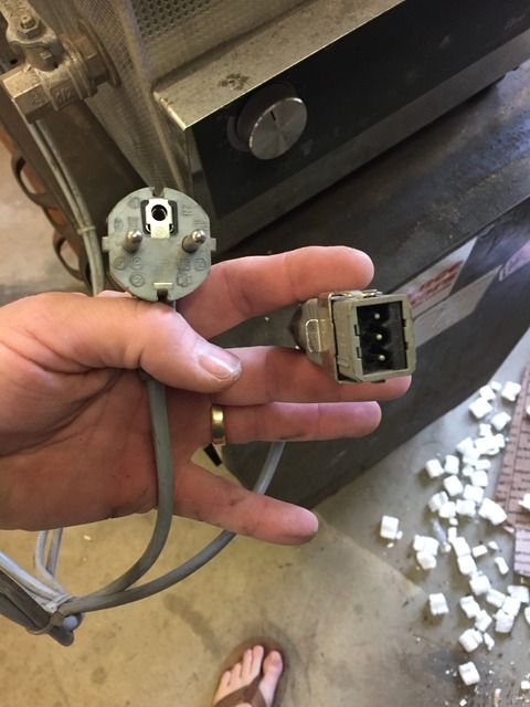

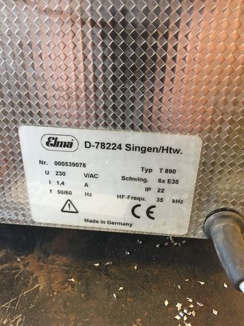

I was given this ultrasonic cleaner. I don't know if it even works. I don't recognize the type of electric plug. If anyone is familiar with any of this please get me started hooking it up!

I can't help with any info on the cleaner but the mains plug (the round one) is a standard 230 volt single phase ac plug as used in continental Europe - well certainly in Spain anyway. The live and neutral go to the round pins and the earth to the side contact. In Spain the plug will go into the wall socket either way up so it's pot luck as to whether the on/off switch on the unit winds up switching the live or neutral. If you are changing the plug try and find out which of the wires from the plug goes to the switch and make that the live connection. You may find that both wires go to the switch which would then be a double pole device switching both live and neutral, and then you'd have no worries which side you connected to live.

Even worse - that type of european plug doesn't have provision for a fuse. The cleaner will be relying on a unit mounted mains input fuse if it's got one, but being of German manufacture I'd be very surprised if it didn't have one.

Did a search and found the operating instructions here.

Nope. That's perfect!

To test an ultrasonic cleaner you generally use the foil test. This involves suspending strips of aluminium foil at various points in the bath and switching on. After 10 / 20 seconds you should see pin holes in the foil. In an ideal world all the strips should show the same damage.

Type F Schuco plug. you can get adaptors to 13A 3 pin (Maplin)

I tried it with some aluminium foil this evening, pin holes! no more like lace curtains, so I suppose it works.
