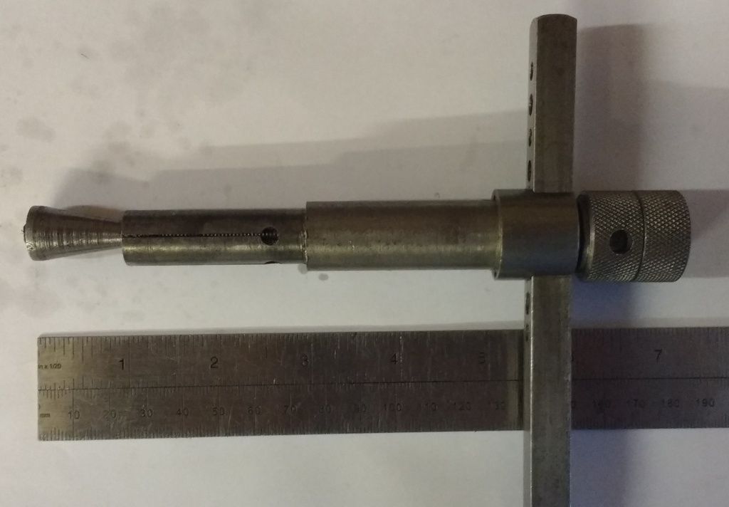

Jon Gibbs10/08/2016 08:14:42
750 forum posts
Hi Jonathon,

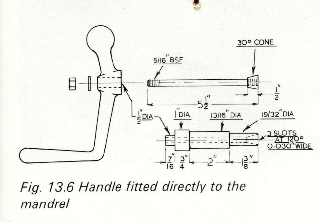

My mandrel handle is based on the design in Ian Bradley's book on the 7 Series Myfords...
and here's a picture. It's just made out of BMS and after 2 years of regular use it's still going strong.
Mine uses M6 studding loctited into the outer knurled nut and four slots (easier to drill the relief holes). The inner nut with tommy bar hole is used to tighten up the tapered plug into the socket. Note: that the male taper is only threaded and is free to move - it doesn't rotate in use as might be expected.
After it's been tightened it does take a light tap on the slackened off outer knurled nut to free up the taper.
HTH
Jon

I made an adoption of Ian Bradley's design The handle arm was a length of slotted steel strip. The slot engaged in the collet shaft where the 1/2" diameter end is shown and the arm was clamped in place by a collar under the nut that draws the taper into the assembly. It was simple and I never had any problems with slippage. Also it was very easy to remove once used unlike the Myford supplied mandrel that can need encouragement if pushed fully home in the bore.
Unfortunately I gave it away when I sold my Myford Super 7. It was one of the most useful, and simple, tools I have made
JA

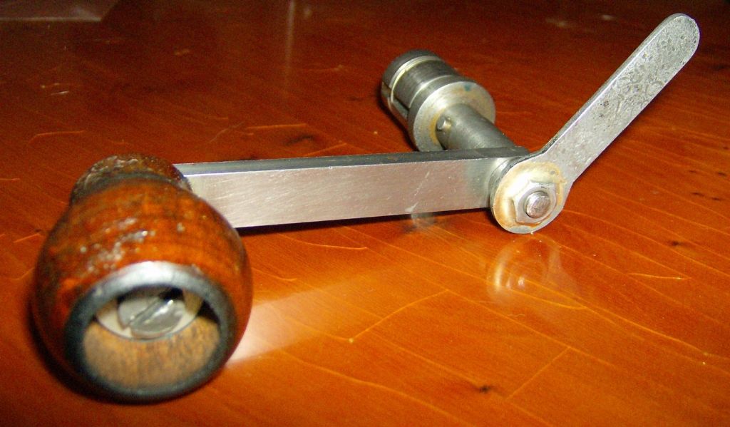

Neil Wyatt10/08/2016 14:41:48
avatar
19226 forum posts
749 photos
86 articles
My version uses a fully spilt collet about 1" long, the two collet halves are kept in place with a circular spring from a keyring.
handle 1
handle 2
