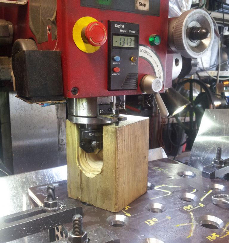

I cringe every time I have to whack the drawbar. Not sure how much damage it does to the bearings. Would like to add a removal tool for releasing the cutting tool but have not worked out how to do it yet. I have a Sieg SX3 mill which has a slot in the side of the spindle for removing chucks that have a tang but not much use for tools with a draw bar.
What I do is support the mill spindle with a wooden block and hit the drawbar with an aluminium mallet.
Paul.

JasonB16/12/2014 09:14:23
avatar
25215 forum posts
3105 photos
1 articles
You may want to let the mill run for an hour to warm it all up, if the tooling was inserted into a warm spindle which then contracted slightly it won't come out as easily.

Neil Wyatt16/12/2014 09:44:57
avatar
19226 forum posts
749 photos
86 articles
We recently ran an article in MEW which , in short, described a bit of pipe which was large enough to surround the tooling and a slotted plate to fit over the top around the end of taper and support the spindle, essentially the same as Paul's suggestion but a bit more rigid.
With the spindle supported properly you can whack the drawbar hard and avoid any damage to the bearings.
Ady's suggestion is worth trying, mill a bit of aluminium - less likely to damage the cutter, and fit the drawbar but leave it loose enough that the tool can only drop a mm or so as extra insurance.

Bring the quill section which actually holds the taper down onto a piece of wood which is sitting on the table, release the drawbar a couple of turns and hit with a copper mallet or similar.
As you are supporting the quill in this way the bearings shouldn't be loaded.
Tony

Where do you think the bearings are?
By design and construction of mill, those things underneath the quill do nothing to take the load off the lower bearing if directly under quill. It needs to be on the protruding taper that revolves.
There are better arrangements but essentially nothing wrong with MT3, back drawbar off 1/4 to 1/2 a rev then short sharp dead blow following through guarantees. I leave a 4lb hammer held close to the head and 17mm spanner within reach just for this purpose. How do you think the pneumatic drawbars work without using above and no quill lock. Think this calls for a video tutorial, just got to have the knack.
