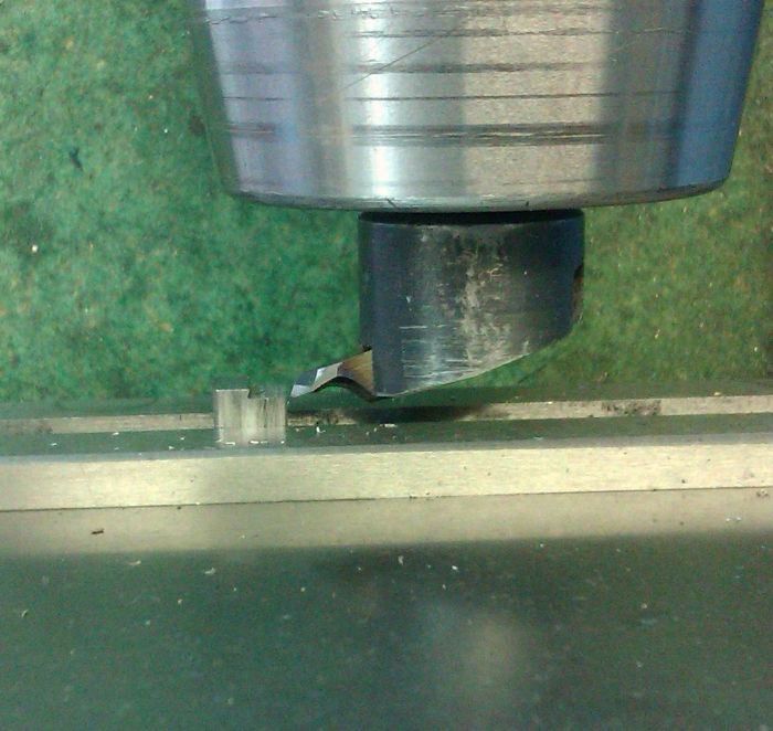

I need to cut some female dovetails in aluminium. The slot will be about 30 wide and 6mm deep so a cutter head diameter of 15 would be ideal. The 55 degree angle is to match some existing camera equipment which incorporates the locking mechanism so the angle has to pretty close.
I can find lots of 45 and 60 degree cutters but 55 degree ones are either very expensive of have to come from distant shores.
Can anyone recommend a UK supplier or have a cutter lying around that I could buy?

Hi Ian,
You could easily make a dovetail cutter for this application. I made a 60 degree cutter using a TCMT insert as shown here:
http://mikesworkshop.weebly.com/dovetail-cutter.html
If you cut the recess for the insert so that the bottom of the insert makes an angle 5 degrees to the horizontal than the cutting face will be at 55 degrees.
Alternatively you could cut the 55 degree dovetail using a 3 mm straight milling cutter with the work mounted at the appropriate angle. This will give a slight undercut to on the base but unless the material is very thin this will be of little consequence.

If it was 60 degrees a standard triangular tip would make it easy (but then 60 degree cutters are plentiful) If I tilt one as you suggest the bottom face of the channel would not be flat. That also stops me using small diameter endmill at an angle.
Johnf
Whilst silver steel suitably hardened would be OK I dont have the skill and patience to make a multi edged cutter.
I dont have a vast quantity of dovetails to cut (10 females about 60mm long) so all in all its not a vast amount of metal to remove but I want to achieive a nice repeatable finish without having to cut very slowly. I have done similar profiles before using woodworking router bits, they are not ideal in aluminium but often very good value for the money.
Based on what Michael said I could use s ready made 45 degree dovetail cutter and tilt it 10 degrees, It would mean I had to tilt the head of the mill and that really is too onerous for me to do, ever! (Loose shims in two planes means precise tramming take hours)

Hi,
Why not make a cutter as Michael Cox suggested, but use a 55 deg DCMT carbide insert.

I did think of Freud, there are none in an old catalogue I have so I looked on the website. I actually doubt they do one at 55 degrees but I had to go through hoops just to find the angle of the ones they do make! The indexing and search on their site might be OK if you know the shank diameter of the cutter or what industry the cutter is used in, but you cannot choose by cutter shape, just weird.
If you need router cutters, I can recommend 'Wealdentool.com' I have found their cutters and prices good.
Barry's idea is one I had not thought of. I'm not sure if I could make a holder (for two tips preferably) to the required accuracy but its got me thinking of buying a pair of the super sharp, polished aluminium cutting inserts and having a go.

Thanks for all the ideas. I have some DCMT (11) tips and I think a single edged cutter using one would work. Using two tips would make the overall diameter too large because the back halves of the trapezoidal shapes would clash. Using smaller than TCMT11 maybe OK but the holder would be more fiddly to make.
Another idea that I cannot use because I dont have a cutter grinder, is to modify a 60 or 45 cutter to 55 degrees but I may investigate getting a sharpening company to grind one.
