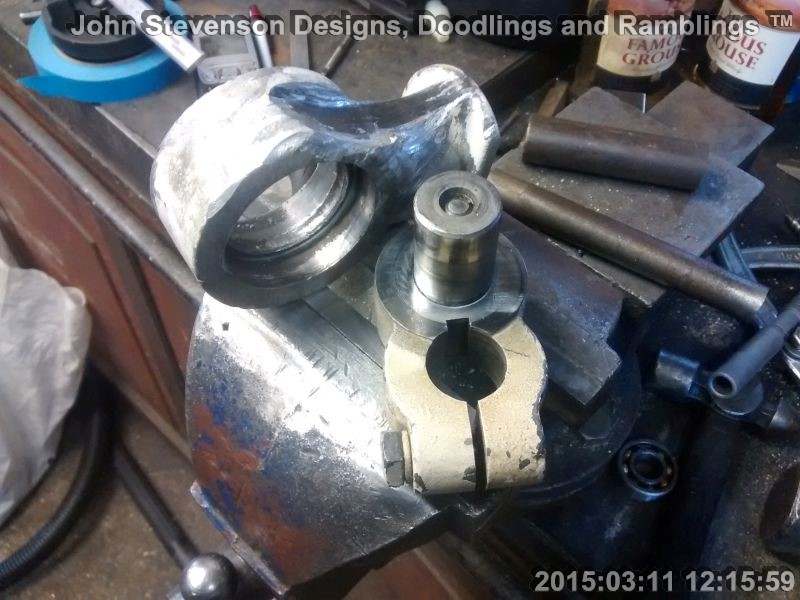

In the meanwhile this fell on the floor today.

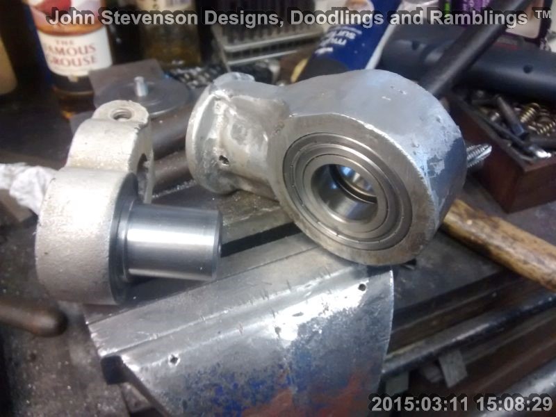

No idea what it's off the the link goes onto a geared motor and drives the yoke. Problem is it was fitted with some special needle roller bearings that ran direct on the 28mm shaft of the link. Link is a steel casting and the pin is hardened and it's not in too bad a condition but 28mm bore bearings with an OD of 60mm are not available.
Add the this it wasn't spotted in time has has walloped the yoke a few times and there is one decent crack into the bearing housing.
So bore the pin out, make a new pin out of EN hardaswhitchestits to 30mm instead of 28 and press in.
Slap some weld onto the yoke, wait for it to dry and bore out to 62mm for a standard bearing.
Looks passable to me so must be brew time.

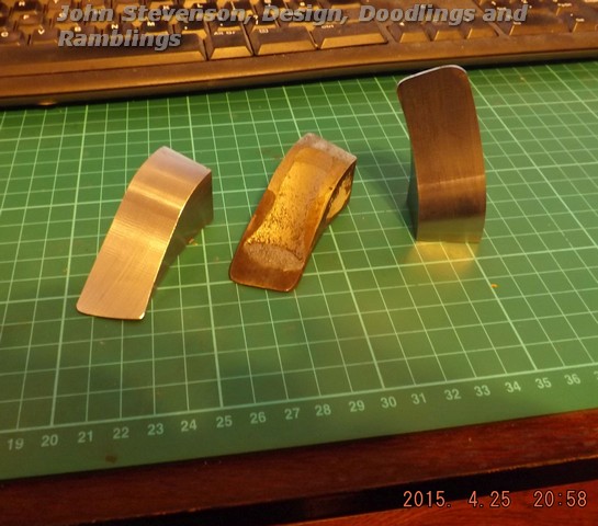

Well Fridays job and not today and not that relevant unless you have a 12 tonne tablet stamping press in your workshop.
Just thought it looked pretty. cheeky
It's a face cam that bolts onto the start of a circular cam that raises the dies up and another set about it pushes them down. Quite slow moving about ? 60 revs per minute but they take quite a load. No spares, machine must be wartime or even pre war.
Other than the base and end joint there isn't another straight line on it anywhere. Could have chopped them out of a big steel ring 260mm in diameter but terrible wast of metal plus still need to do the face which is made up of 2 curves, so carved it out of two pieces of 35 x 35 x 75 on the CNC. Total machining time 38 minutes per piece but that doesn't include prep work, programming or fixturing although by a fluke the tapped holes in the base lined up with one of ARC's 20 x 40 x 80 blocks.

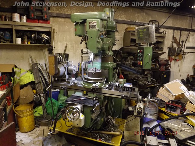

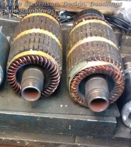

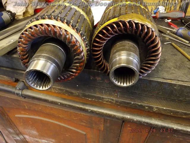

Last week on the " What did you do today ? " post I put some pictures of of some Bridgy rotors, nothing special about them do absolute loads but in one of the pictures were two armatures out of a very old series fork truck.
Even though they are old they love these are they have no electronics fitted just a few big relays and therefore cheap to maintain. Only problem is they use an old series motor and hydraulic system and they are getting quite scarce but can be repaired electrically but the mechanical drive is a problem.

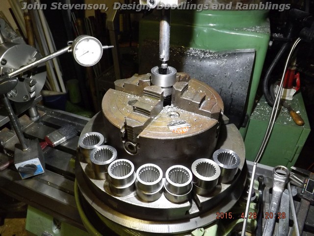

They use a 25 vee spline drive, nothing else uses this and modern drives are involute stub splines anyway and not vee.
Not particularly clear as they were just included in a shot as opposed to being photographed specially. The one on the left has a ring of original spline at the end but inside it's all stripped out. Right hand one is completely gone.
So swing the slotting head round on the Bligeport, fortunately I had the foresight to fit the 4" riser off the old machine as by the time a 12" rotatry table and 8" 4 jaw chuck is fitted it's getting 'real' close.
Slotting head is off a Beaver but modified to fit this Warco VM40 which is bigger than a standard Bridgy, even a genuine Bridgy slotting head won't fit one of these but these Beaver heads are far heavier built and can be modified to make fit.
Rotary table is powered by a Steve Ward rotary indexer so 25 divisions are a doddle.
Only needed two but did eight so got a few spares for next time.
Armatures bored out, splined bushed pressed in and the plain ring in front of the fan splines is where it was welding into position. Ends case hardened and polished and they went out at dinner today.
Next six should be a lot easier to do wink

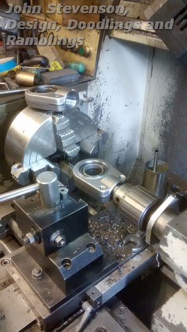

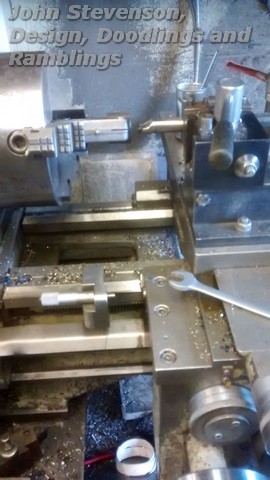

Run of the mill job in today, increase a thread in a rod end yoke from M28mm x 1.5 to M30mm x 1.5. Enough meat to do it as tapping size for M30 x 1.5 is 28.5 so above the present thread.

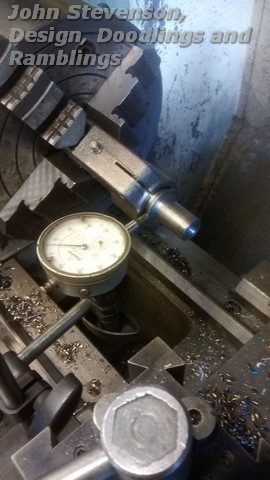

What might be of interest is how to locate the thread.
Quick shot of what we are talking about.
Existing yoke sat on top of the chuck for the picture. As I didn't have a M28 tap I turned a slug up with two different diameters, 26.55 which was a nice snug fit in the threaded hole and the other 16mm to fit in a tailstock chuck.
So the whole assemble was fitted to the chuck first, offered up to the jaws and just nipped. Tailstock chuck was then removed leaving the slug in the yoke and it was then possible to clock up on this slug.
Slight tweak to get central and then fit the boring tool.
This followed by the infernal screw cutting tool and one down, two to go.
Note the bed stop set to prevent the boring or screw cutting tool hitting the bottom of the hole.
This method can be used to hold any irregular shape like a cylinder or anything with a hole in it.
