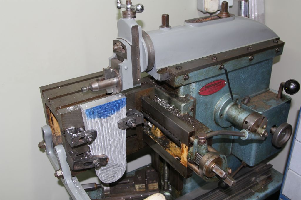

Used my old Royal Shaper to put a nice finish on this bracket i'm making.
Cast it using lost foam in an open mold. The furnace was an old gas cylinder and the crucible a stainless pot from The Range.
