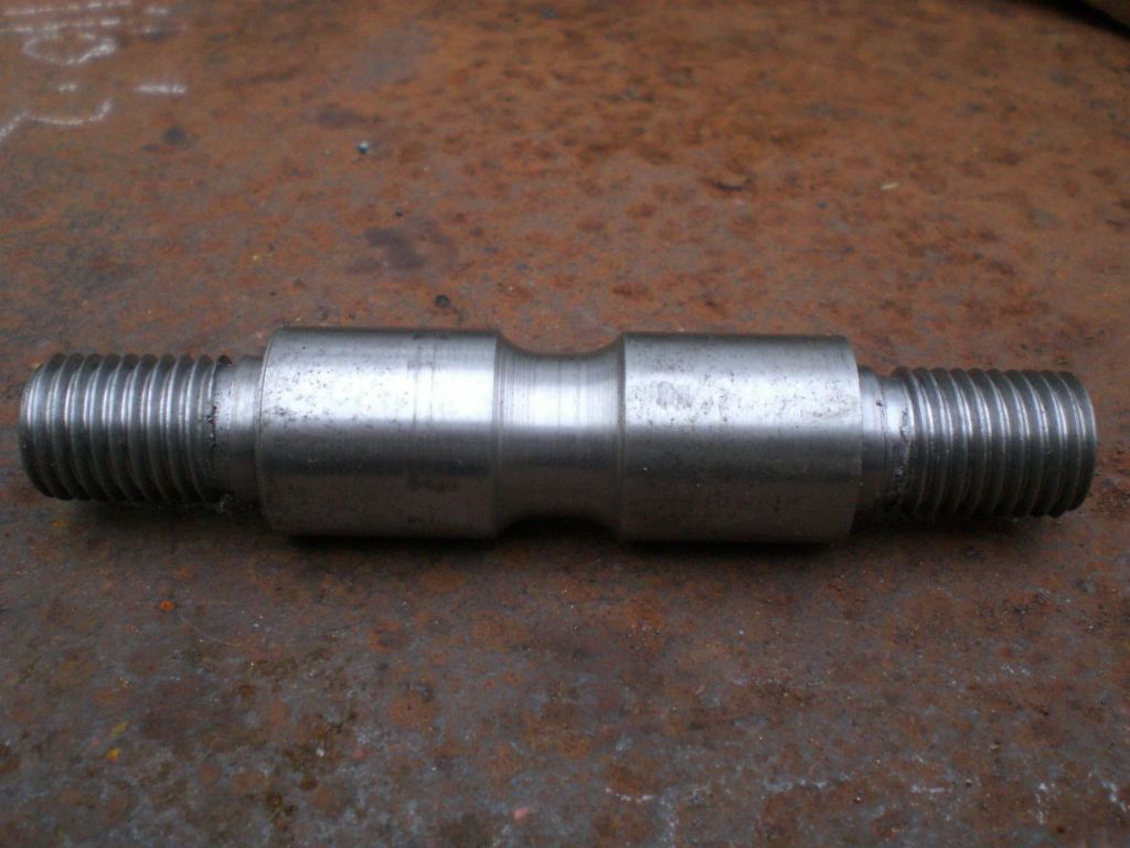

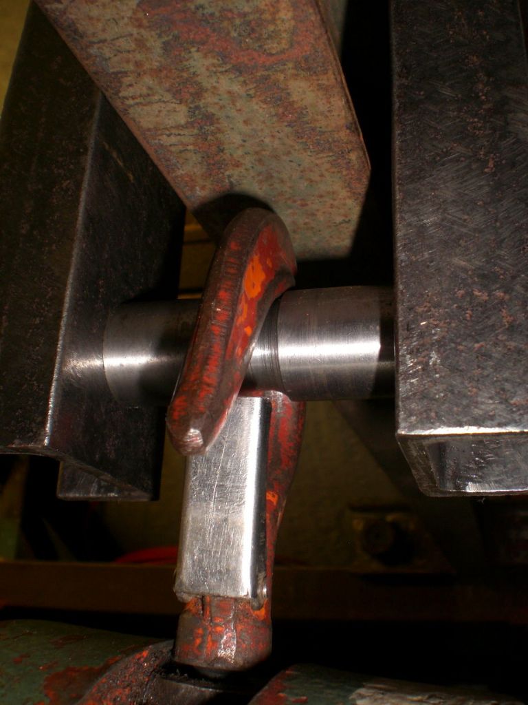

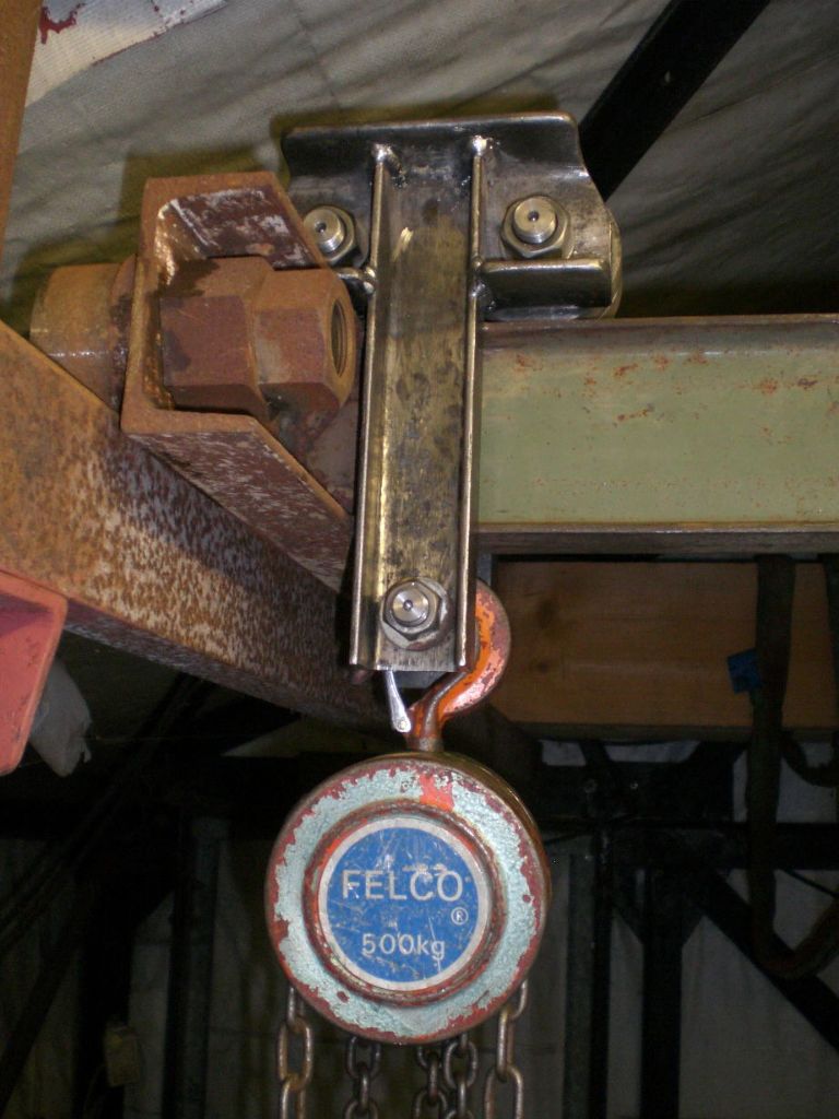

Hi, made the pin today that ties the two channels that hang down below the beam and to which the chain block is held up by.
The reduced portion in the centre is where the hook of the chain block sits and keeps it central to the trolley.
The design of this trolley maximises the full width of the traveling lifting beam.
Just need to make and fit a pair of guide pads to keep the trolley central on the lifting beam and to stop it twisting.
Regards Nick.

i do like Nick Farr's hoist etc. all i need is a complicated system through the house from the workshop then down some steps then 40ft up the garden to the car boot to load my miniature locos unassisted!

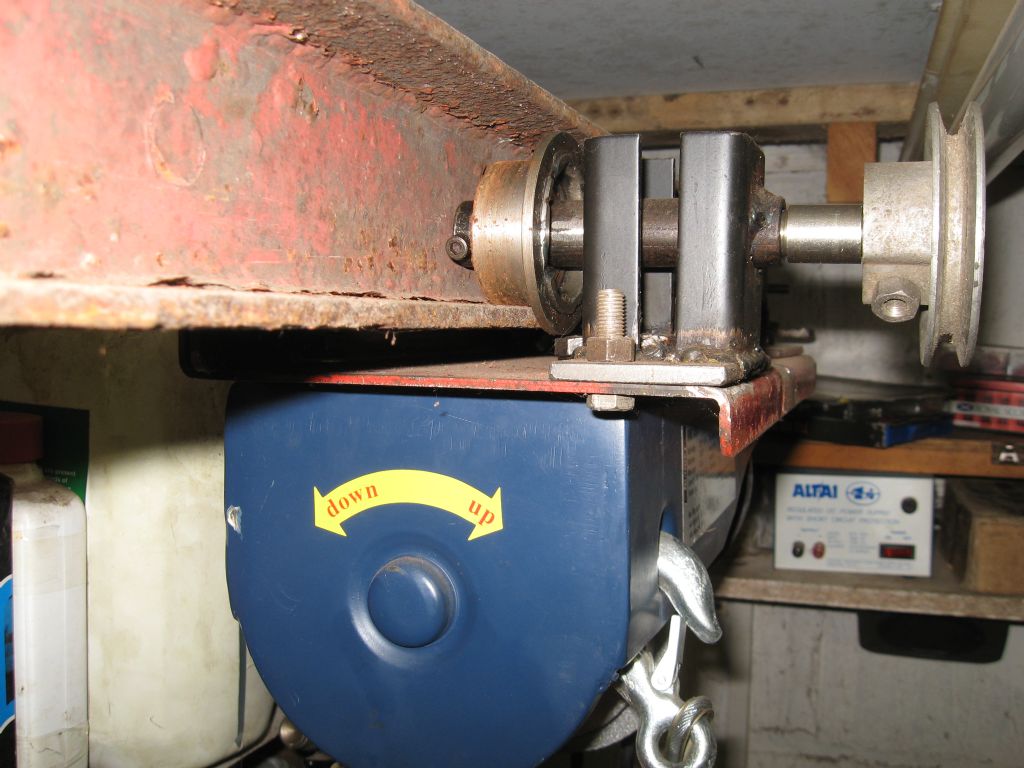

Hi Nick,
I was going to suggest using flanged wheels but it would not fit in with your design. I thought I had put flanges on the wheels on mine but when I went to take pictures I found I had only fitted a flanged wheel to the wheel that can be used to drive it along the track. I did not even make wheels for the other three. I just used the outer of the bearings.
I had just used guide plates on the other three corners.
Les.
