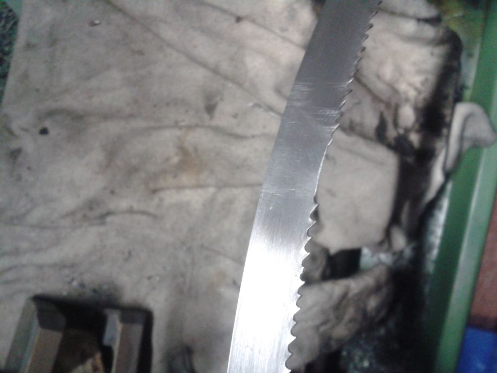

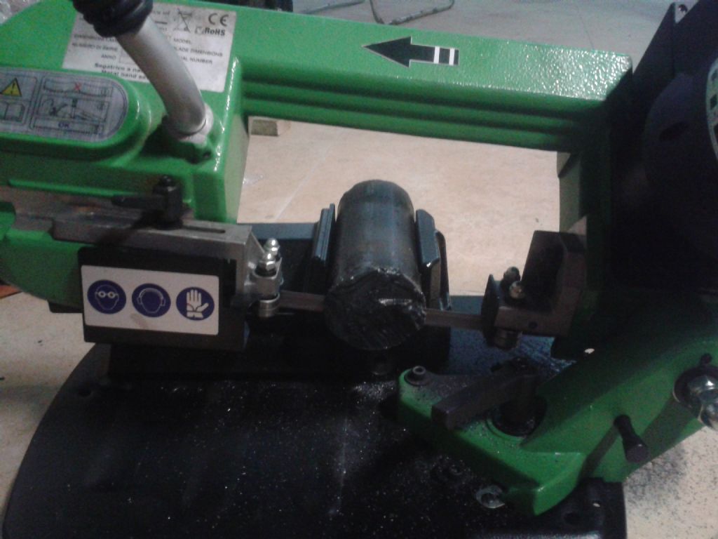

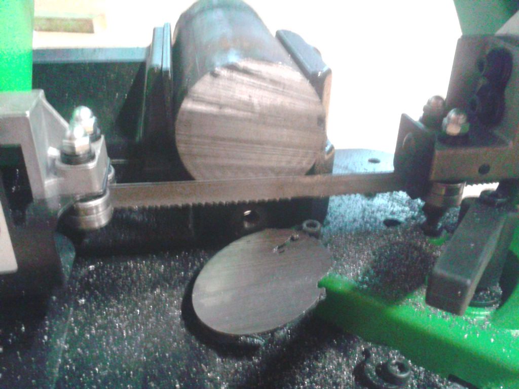

As promised, I had a try TIG welding the blade, set at 20A I put a blob of metal and then filed it flat. First impression looks good. Gave it a test cut on a 2.5" dia round bar and cut it without any problems. So far so good...time will tell if it's a good repair or not, will still order a couple of blades just in case!
