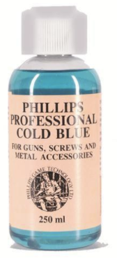

Some great advice guys, I am going to powder coat some bits, cold blue other bits and oil the rest that i cannot repaint.

Brownells cold blue is excellent if one follows the instructions. **LINK** Degeasing is the secret.

Gareth T24/12/2016 22:07:37
avatar
12 forum posts
Picked up some of this at the local Gun shop, I will let you know how it goes with photos.
