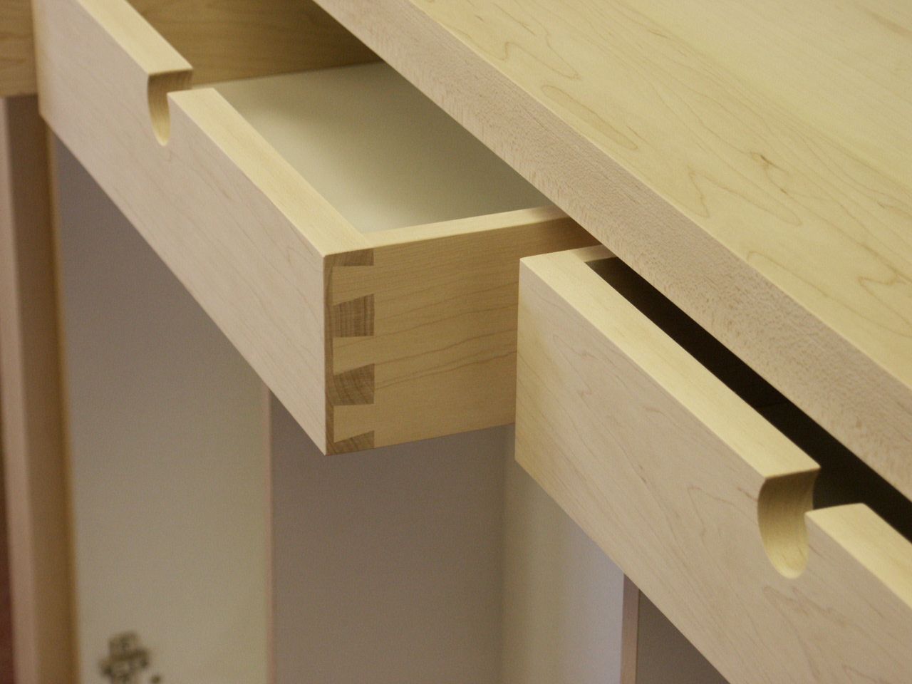

Nice engraving John, only one slight problem you have got your tails and pins mixed up, the idea is that as you pull on the front of the draw the pins will tighten into the "wedge" shape of the tails. As you have it the front will slide straight out of the joint.sad
Although blind this is one I prepared earlier
Edited By JasonB on 10/10/2015 07:39:40

Lovely work, Jason

It certainly is. I tried cutting some dovetails last week. Gave up and used butt joints disgust

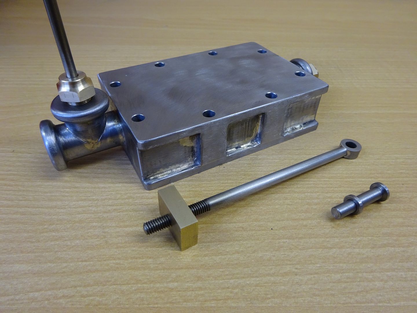

Having got off to a bit of a false start when my propane bottle ran out half way through soldering the Tidman valve chest together I got it soldered OK with some new gas. Then treated it like a casting by facing off the mounting flange and poping a few holes in here and there. Also made tha governor butterfly valve, spindle & gland nut plus the Valve rod, nut, gland and pivot pin & washer. Chest is 2.5" x 3.75" x 1" thick with an unusual integral cover.

That is immensely depressing to we mere mortals !
Nice work - very well done.

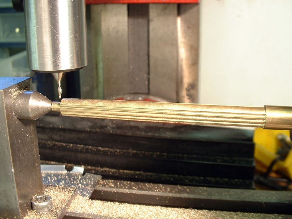

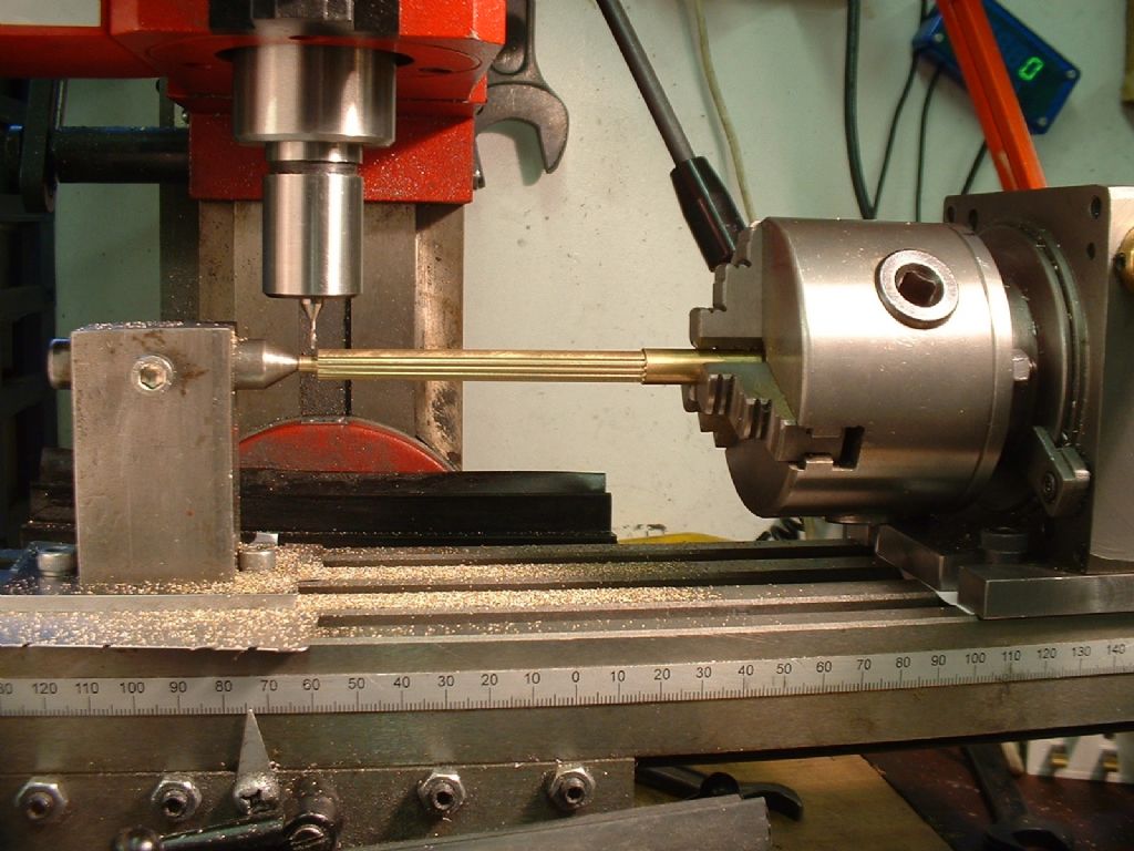

LS.. column fluting - my setup, note packing under tailstock.
As they are brass when you break the round nosed 1/16" end mill you can grind up a replacement from the stub

thanks Neil, I know what I'm doing tomorrow :-/
